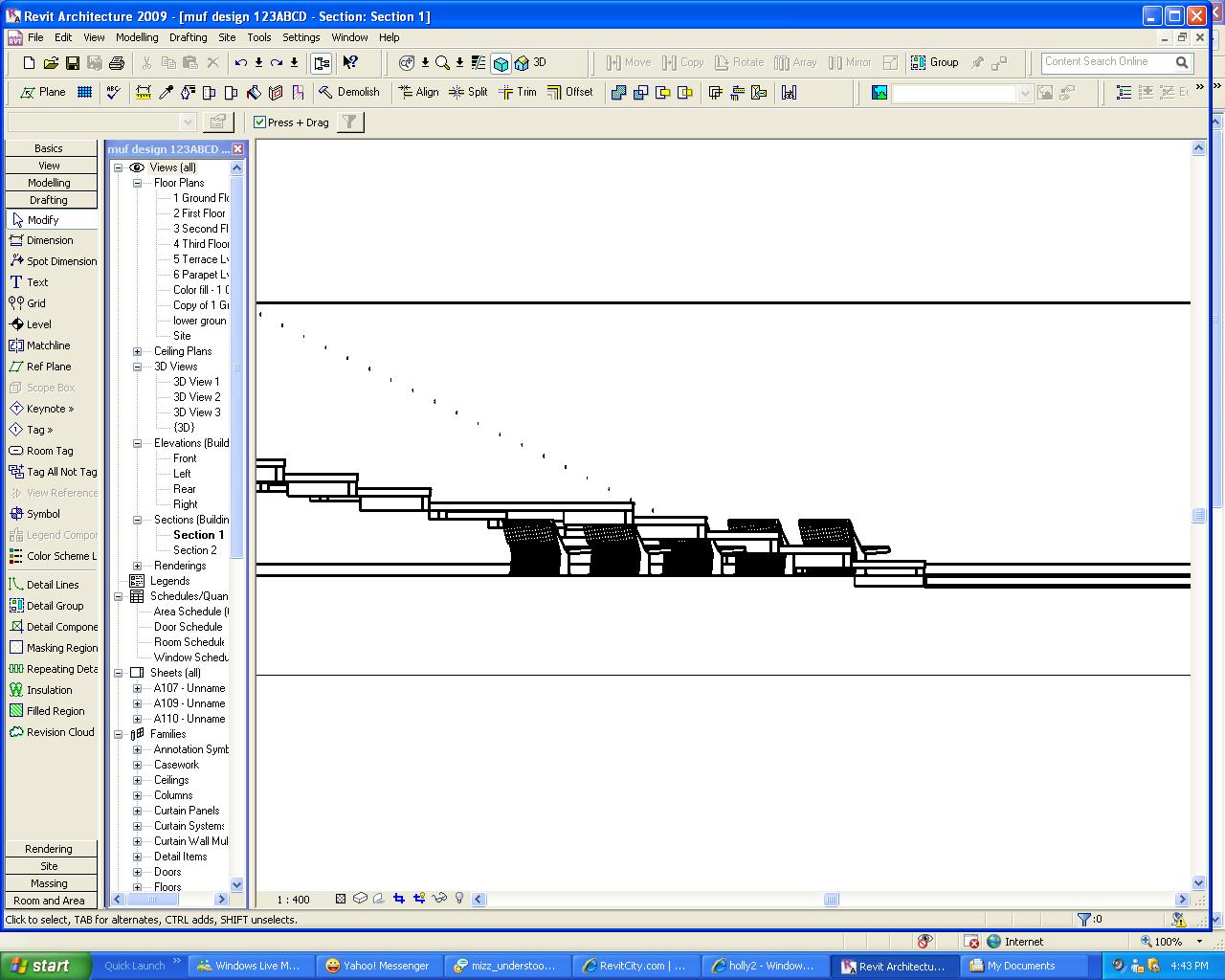

hey man i have this auditorium seat i have seen everywhere people saying abt unlocking the components and stuff i tried editing the family but it neva gave me any option to chnage the componenets i am really stuck as i need these seats to follow my auditorium seat levels so that i can move forward i completely stuck and in need of urgent help...thanks i am also including a sectional view of what i am on abt ....

Upload the seat so that we can see the family.
