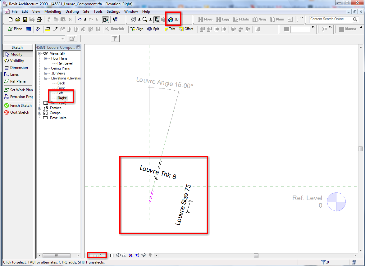

Hi, when you pick in the object and go to "Options Bar" click in "Edit", now you are in "Sketch Mode" the lines turns magenta, then you are able to see the "Louvre Thk and Louvre Size" dimension... change to 3D view or Left/Right view, see image attached... (BT, change the scale if there is too large)

Thanks!Problem solved.
