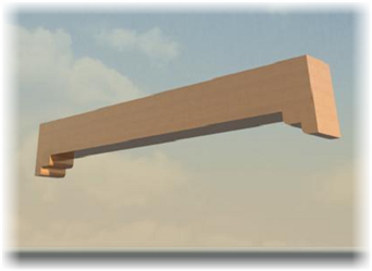

I have always enjoyed using www.revitcity.com and thought I would share my latest video tutorial series.
I just put together a sweet REVIT Training Video series that I'm sure most of you will find of value.
This is great for all levels of REVIT users who want to learn some cool things about making families.
In the videos I create an architectural beam with some abutments (for lack of better word). The lessons learned over the course of these 7 videos should get the wheels turning and can then be used to further you own REVIT family creation ideas.
This is a well organized, step by step process that will (hopefully) get you on the right track in making your own exciting new REVIT families.

- Also, when drawing the completed beam family in the project make sure you set your placement method to 'Work Plane' and not 'Face' (see attached image)
Also, make sure you adjust your 'view range' as instructed if you place it in a plan view.
