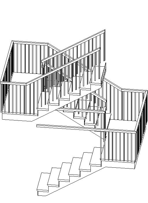

How do i get my railings to be correct. Im goingup 16' and overlapping my runs, but the railings on the first run are not correct. ANY ANSWERS??????
Wed, Oct 1, 2008 at 3:48:49 PM | RAILINGS RAILINGS?????
Make sure the furst run is two lines - the stairs & the landing then click on the stair line & set to slope by host on the options bar
