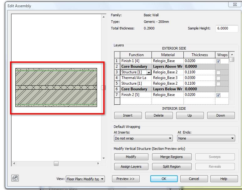

Can you put some snapshots (like i have in attached) to see what it's happen? you check the scale, the VG, Fine mode, so what it's like your wall in plan when you create them?

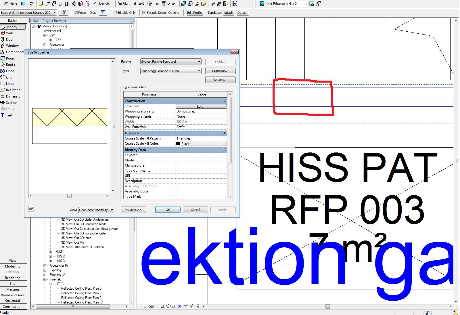

Thanks for your help. Ill put up a picture asap.
The wierd part is that the wall looks fine when I Preview it in Element Properties but nothing shows in plan no matter how much I seem to tamper with view settings...
Mon, Sep 29, 2008 at 1:55:07 PM | Cant see wall material cut in plane
JohanEkstrom
Joined: Wed, Sep 10, 2008
20 Posts
Mon, Sep 29, 2008 at 2:01:50 PM | Cant see wall material cut in plane

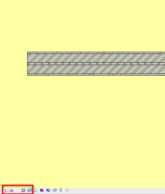

Hi, try this change the scale in that view to 1:20 or 1:10, zoom to the wall and check if the pattern appears, right now you have the scale 1:200....

Ive tried every scale possible...nothing changes. Not even with 1:10 and zooming forever...

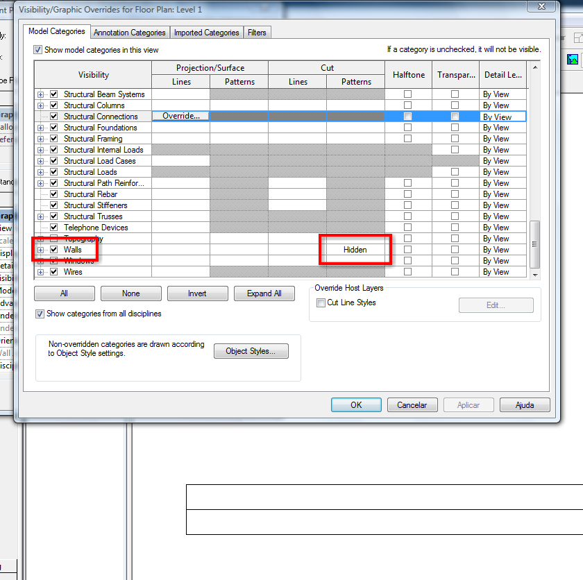

Do you put some "Plan region" on that?, do you check the "view Range-Cut plane" in that view? do you check in the vp Walls like the image attached?
