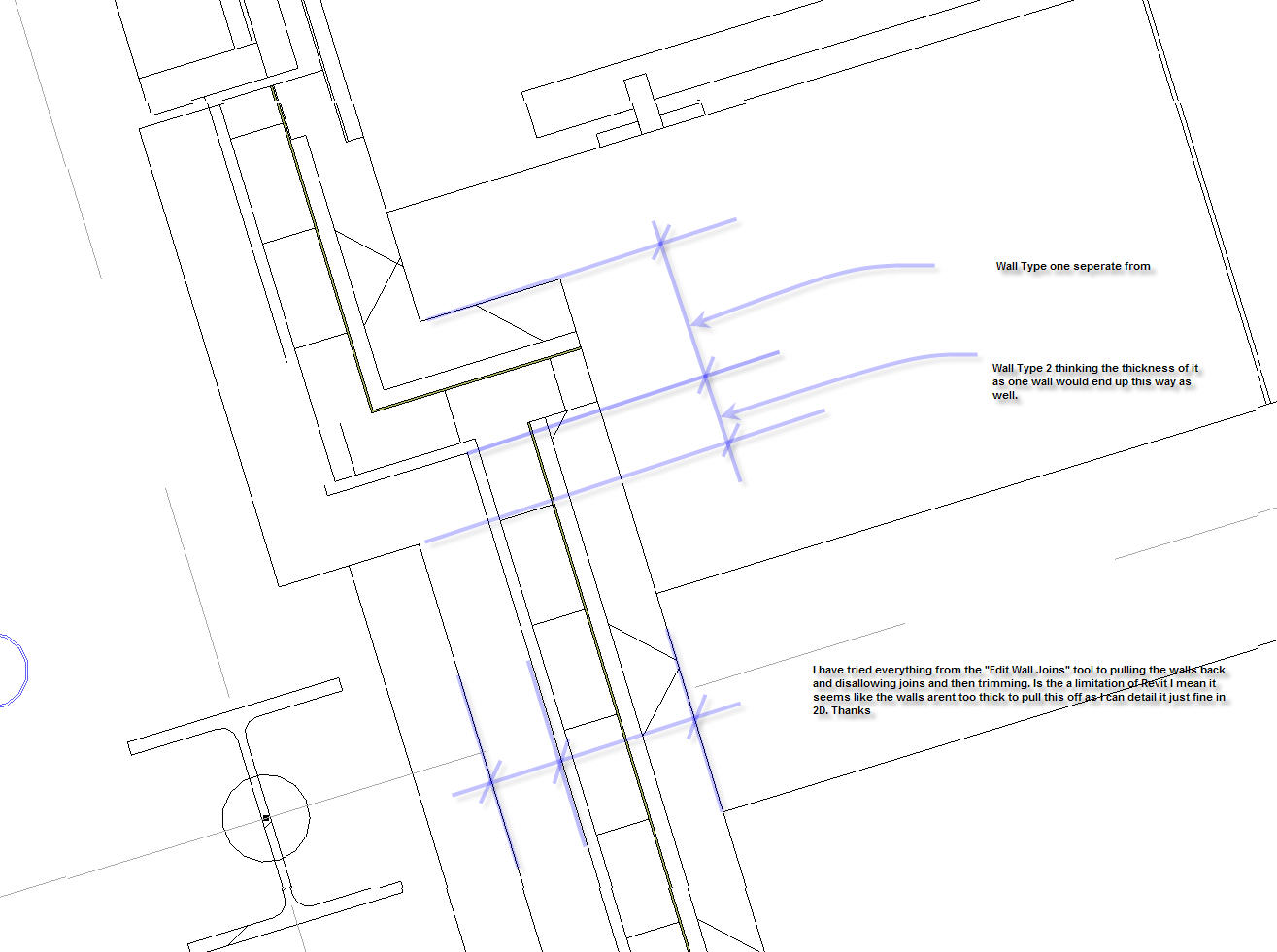

Take a look at my screenshot. I cannot get this to join correctly and wrap the end of the wall. Any help would be appreciated.

I'm having the same problem. Any help would be appreciated. We suspected that it have with the wall being drawn with different location lines. For intance one wall drawn by the core and another drawn by an interior face.

Did you try with the "Edit wall join"??? trim and/or extend the two walls???

The wall join tool did not fix the problem.

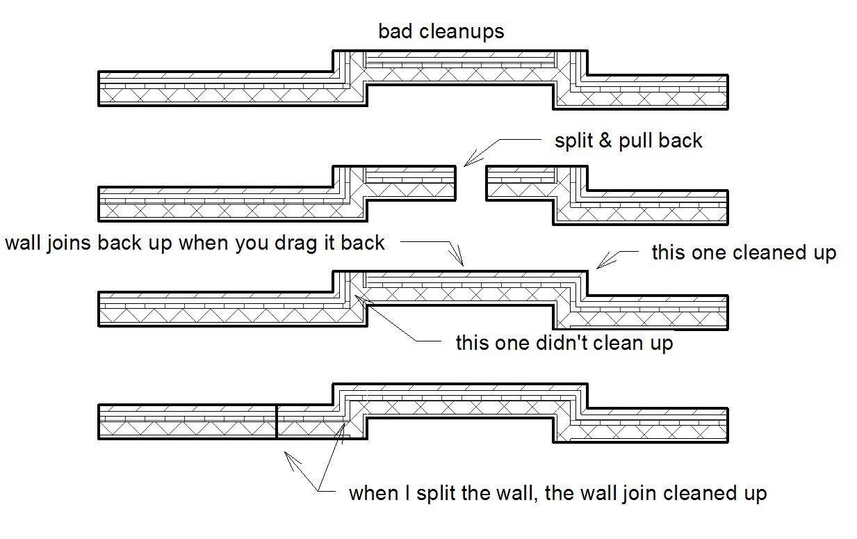

Yeah WWhub, NOW I remember what are you talking, i don't have here "jing" and Revit to make a video but it's when you pick in the wall appears the "Blue Dots" with the temporary dimensons and if you pick Or "drag" those "blue dots" you can fix the problem of those walls...

OK - attached sketch shows what I remember...  REVIT seems to want to clean up the walls in a progession so work in one direction or the other.

Thanks for the suggestion. Unfortunately, we followed your steps of splitting the wall but it only cleaned up one side. This problem appears to happen when a wall offset is less than the thickness of the wall. Draw order seems to play a role. We have tried to drag the blue dots to clean things up wich has worked in some instance but not others. The link mentioned earlier would be a huge help. This is our firm's first pilot Revit project. Little 'quirks' like this can make the partners and decision makers skeptical of Revit, when this prblem wouln't occur in Autocad. I am really thnkful for this forum and the help everyone supplies.

Look at all the sketches ... it cleaned up one side.... split the next wall and the other side cleans up - then rejoin that wall!

Hi, this is the other solution i'm was talking, see the video: http://www.megaupload.com/?d=XIIE4P9E
But it's faster the way of WWhub....
