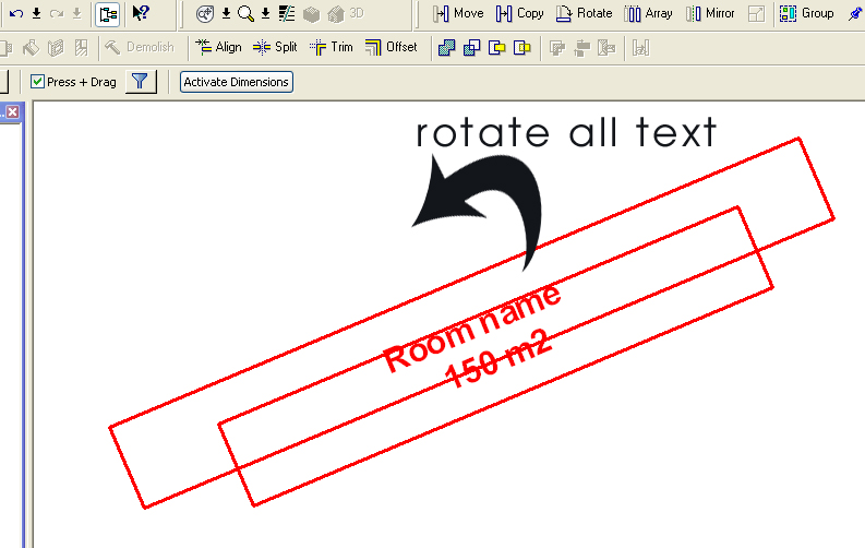

Yes, I think You can make a parameter to rotate, but it's a difficult proplem. Open room tag family, rotate all text, make another room tag type. Just a minute Smile
