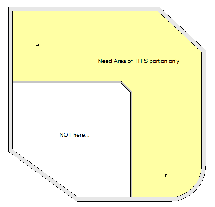

I have a "loft" on my second floor in Revit (2009) and I don't want to enclose the floor, but would rather just a railing to act as a wall. My problem is that I need to get the area of the floor but cannot do it with room tags
 Help?!

Use "Room Seperation Lines" (found on the 'Room and Area' tab on the left) to enclose the area and then add a room element.
