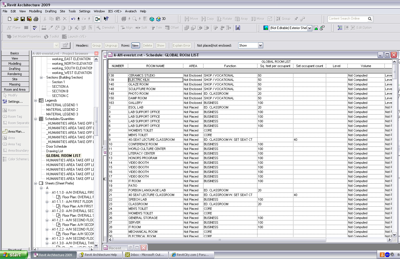

In RAC 2009, I can not delete a room that is "Not Placed" or "Not Enclosed". The option to do so is simply greyed out. Any thoughts on this? Take a look at the attached image.

If you right click on the row, is delete greyed out there as well?

I ended up deleting the room schedule and then re-creating it and the unplaced rooms were gone. I believe I generated so many of unplaced rooms by using teh Avartech room re-number tool. In any case, deleting the schedule and re-creating it solved my problem.
