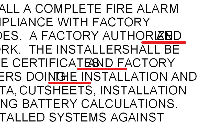

I have copy clipped all of my text over from autocad with a TTF fond and width set to 1. I went and reformatted everything with the tabs in the revit text box. Everything looks great. Then i click in the box to edit something and all the formatting goes to !%$&.  All the tabs are now off and it looks like I will have to reformat everything again. Then I click on something else and it all goes back with no ryme or reason. Does anyone know what causes it to freak out or if it is freaked out how get it back?
Wed, Mar 18, 2009 at 5:42:15 PM | Linking CAD - Text Sheets
#9
davbrink
Joined: Mon, Dec 1, 2008
43 Posts
4 Stars: 1 Votes
I have added a image of the screwup that Revit gives me. Which is totally unacceptable.
