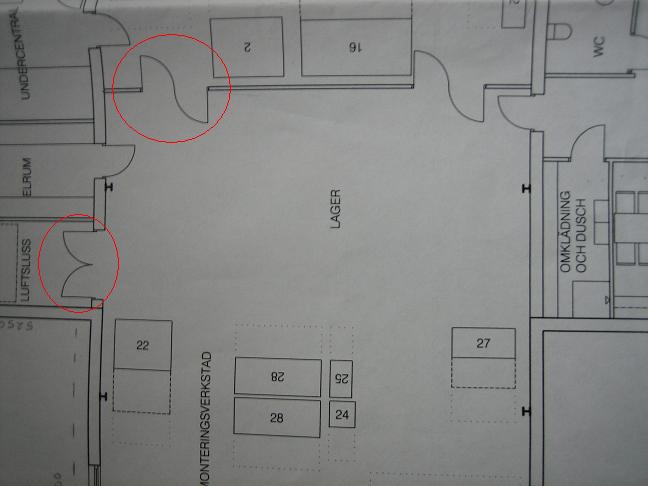

We're building a _really_ simple warehouse based off a very simple blueprint.
My problem is that I have to build two different types of doors and I have no clue whatsoever how to create them.
The basic doors are no problem but I think the other two are a bit special. I'll give you a link below so that you can see which doors I'm talking about (the ones with the red circle around them):
Link:
http://img227.imageshack.us/my.php?image=revitdoorsxm7.jpg
Would appreciate any help if you know how to make these, just remember - I am really noobish Winking

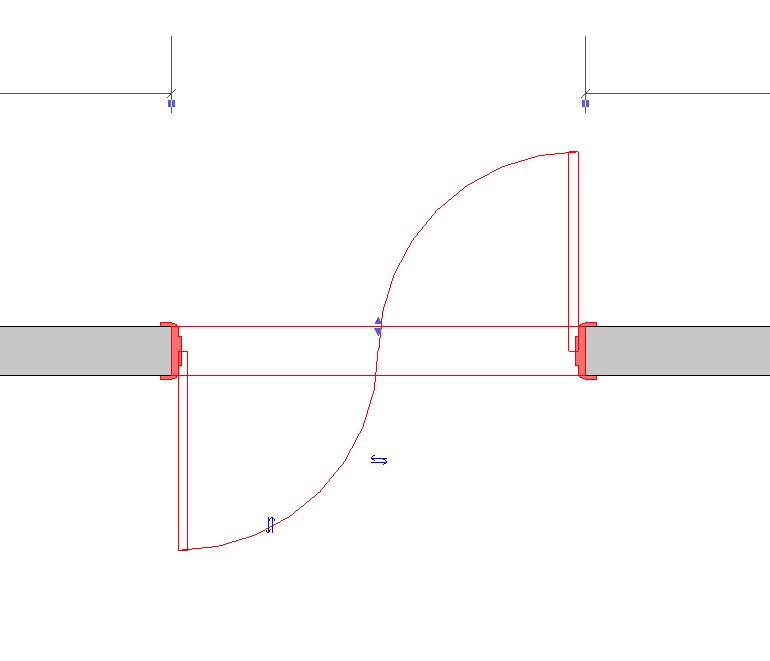

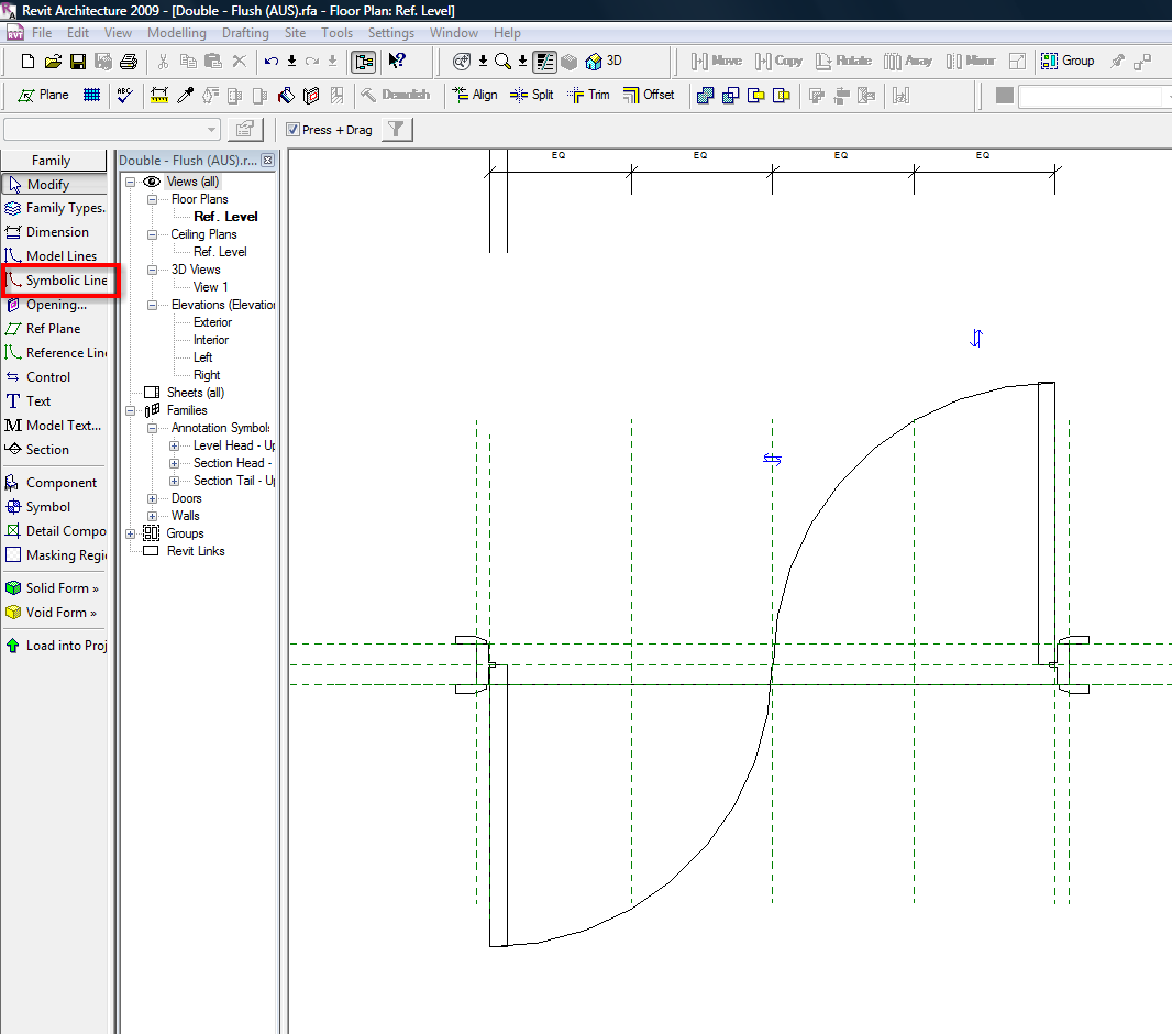

You can do that with "Symbolic Lines - Plan Swing (Projection)"...

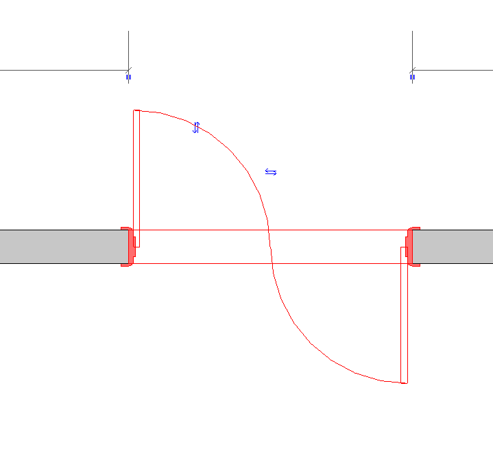

" how did you actually make it and will these lines really look like an acutal door?" well you can create this in a family door or you also can open an existent double door and change in plan this "symbolic lines" like you can see in the first image...

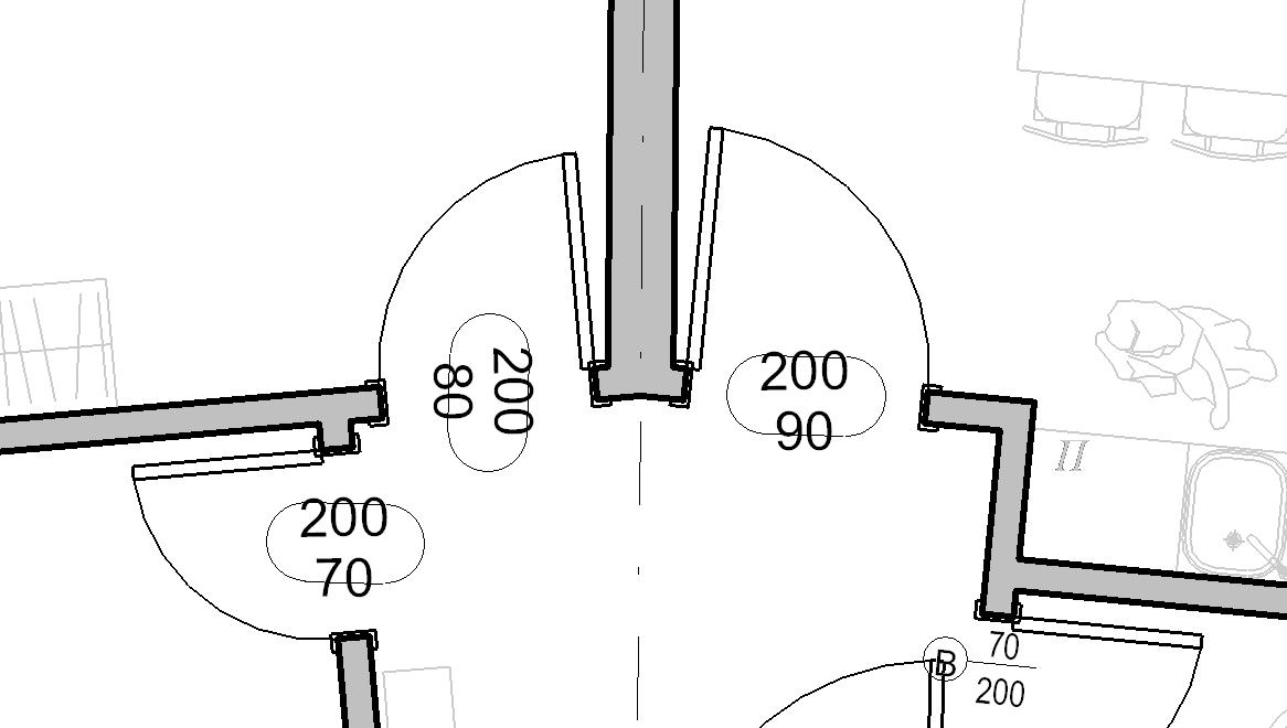

Hello!Smile))
how to connect door tag with the angle of rotation of the door (or not to be only horizontal or vertical )I know it's possible but i don't know how to do that
Thank youSmile))
Tue, Sep 23, 2008 at 12:48:28 PM | Revit Doors
JAMESHGRIMES
JAMESHGRIMES Avatar
Joined: Fri, Apr 14, 2006
584 Posts
4.5 Stars: 10 Votes
Edit the door tag family and go to Setting-->Family Category and Parameters and click the check mark box that says "Rotate with component". Then reload that family into the project.
