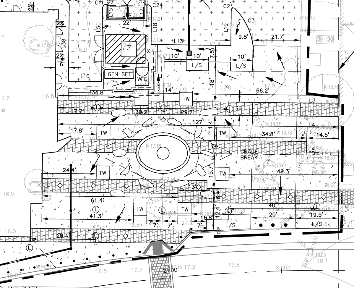

My civil and landscape dwgs are not representing correctly in my revit site plan. Graphics are way off and sometimes being represented by random, small, solid black triangles. Any suggestions?

Can you post an image?

See attached for revit and CAD representations of the same site info. You'll notice that the CAD linework that defines the concrete score marks doesn't represent in revit but for the triangles lining the edge of the pathway. You'll also notice the CAD linework for the crosswalk near the bottom center of the revit image is almost there but the linework does not clean-up correctly, etc.

I think that your problem may have to do with AutoCAD blocks.  Your cad drawing may be a bound xref which may be a block or the drawing itself may be a block.  If this is the case, explode your drawing and reinsert it into Revit and it should read correctly.  Post again if this does not solve the problem.
