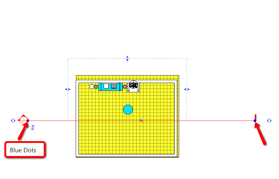

Is there a way to edit the extents of section lines in plan in 2d without affecting the view range of the section view itself?  We have a whole building section line that should show on a partial plan, but the section line is extending the full length of the building even though the plan ends. This seem to be possible, but when I try to drag the section line, I can't click change the end location.

Hi, i don't know if this is exactly what do you want but you can pick in the 2D section line and drag the "Blue dots" at the end of the section line and in this way you don't affect the view in section, see the image attached.
