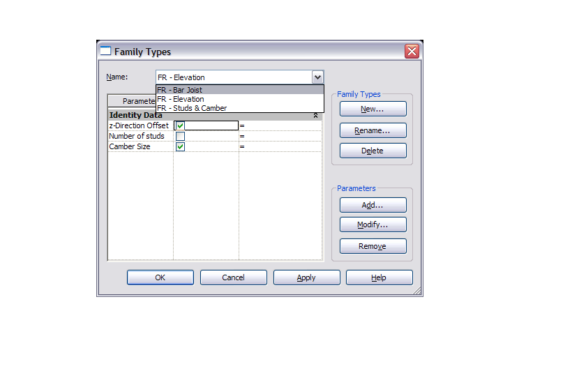

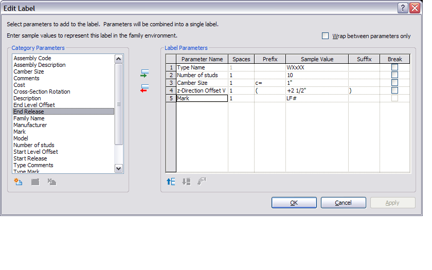

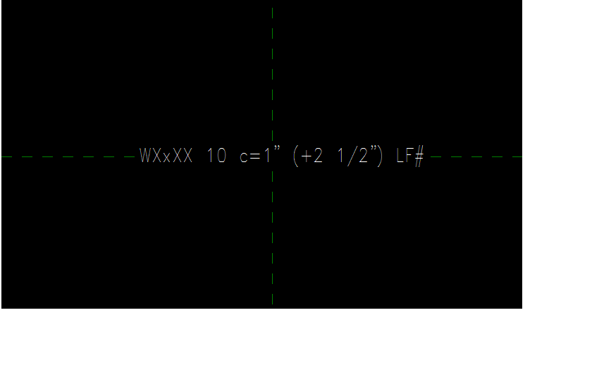

I am trying to create framing tags for composite framing, barjoists, etc.  I have created a family called "Structural Framing Tag".  In this family I have a label with the parameters shown in the screen shot.  I have created family types such as "Bar Joist", "Studs and Camber", "Standard" (See Screen Shot).  For my Bar Joist Tag framing tag I only want the Beam Name to show up.  For Studs and Camber I want everything to show up except Z-Offset Elevation.  For Standard I want the beam name and the Z-Offset Elevation to showup.  How do I make only certain parameters visible?
The only way I have found to make this work is to create a separate family for each tag.  I would prefer having one family with different family types.  Any help would be great.

  • rkitect : Part 1: http://tinyurl.com/46adjd
  • rkitect : sorry about the music
  • Steel2Steel : i assume thats for me rkitect?
  • rkitect : yes
  • rkitect : http://tinyurl.com/498246
  • rkitect : part 2 --^
  • rkitect : looks like you got half of it, just needed associate the parameter with the visibility of the label
