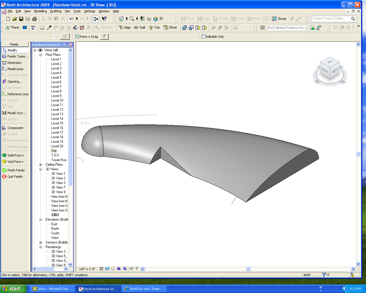

Wondering if anyone can help me with massing this object.  I'm trying to curve the right hand side of this object (screenshot attached) downawards...almost as if I had taken a piece of sandpaper and rounded of the edge.  Seems like some sort of void sweep or void swept blend would work, but I haven't been able to get it.
 Thanks for any help.

Hi, where is the screenshot??
Thu, Sep 11, 2008 at 7:19:24 AM | Roof massing
faitbuf
Joined: Wed, Jul 11, 2007
19 Posts
Hmm...let's try again and see if this works.

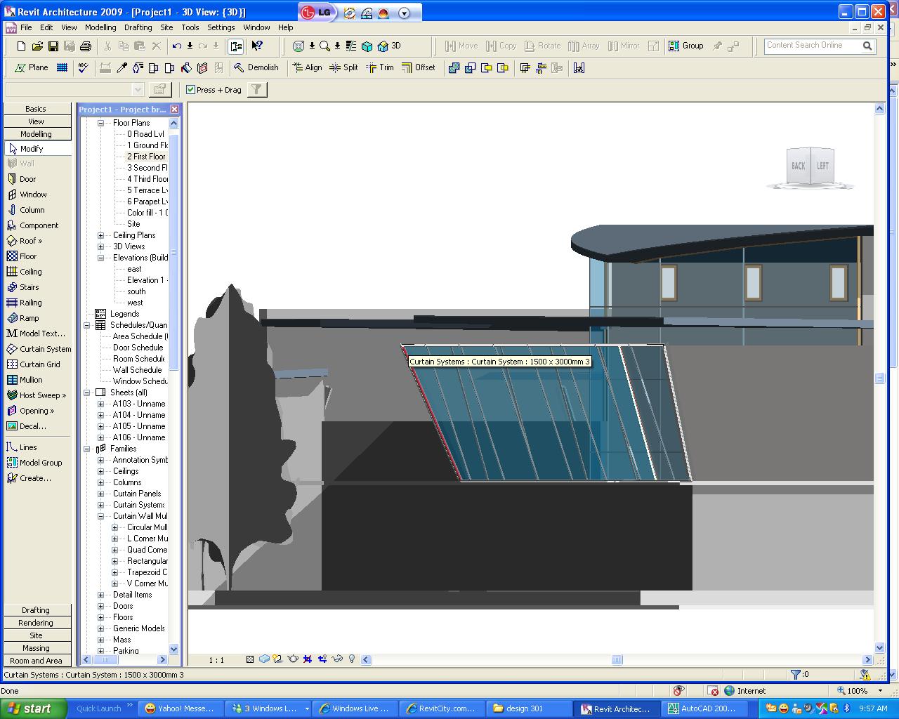

hi guys i created  a slanted curtain wall using massing, and now after i created the roof it leaves a gap and thus i cant  attach the roof to the massed(curtain walls) please provide me woth a solution for this, and i would also like to know how u can split a flat roof sloping inwards into Aa 'V' please its quite urgent so replies would be highly appreciated.

I can't help you with the curtainwall becuse you didn't give enough information.  Hope you do documents better than you ask qustions.   A suggestion - if you did curtainwall by face, it should be as big as your mass - I would assume you used an automatic curtainwall ... did you set all of the components up correctly as they relate to the curtainwall installation point.  You can controle their depth of placement from this reference point.
For your 'V' roof ... two roofs joined or roof by extrusion.
As far as your time frame ... plan ahead - learn before you leap.

Wed, Apr 22, 2009 at 9:05:12 PM | Roof connection of massed curtain wall
Mufu
Joined: Sun, Apr 19, 2009
25 Posts
hi typhoon i really appreciate ur replies its urgent as i am just tryin to complete one o fmy projects which is die and am using revit for the first time and WWhub i do appreciate ur reply, well here's the image of what i am trying to do and yes i have done the automatic curtain walling system, so i need to help on what to do next ......muf
Thu, Apr 23, 2009 at 2:01:49 PM | Roof massing
Joined: Tue, May 22, 2007
5921 Posts
4 Stars: 205 Votes
You have already the "Mass" where you create the curtain wall??? if so, pick in the mass and pick in the options bar "edit", change the mass like you want (create voids IF you need) touching the roof, then finish the mass, pick in the curtain wall and in options bar click in "Remake", done, sorry for the delay, i just see this right now....

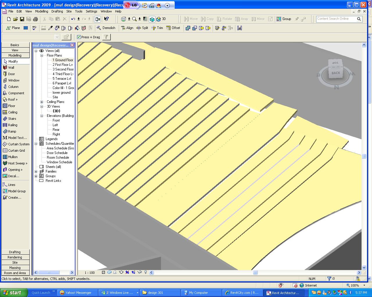

Sun, Apr 26, 2009 at 4:39:42 AM | auditorium!!
#11
Mufu
25 Posts
hi there i managed to get the steps of the auditorium now the thing is i cant add steps nor get the floor which i opted to slope  to meet the stairs please i need advice on this and as usual its quite urgent Winking i ahve included an image aswell

Sun, Apr 26, 2009 at 7:01:06 AM | Roof massing
#12
5921 Posts
4 Stars: 205 Votes
Did you use stairs on that????

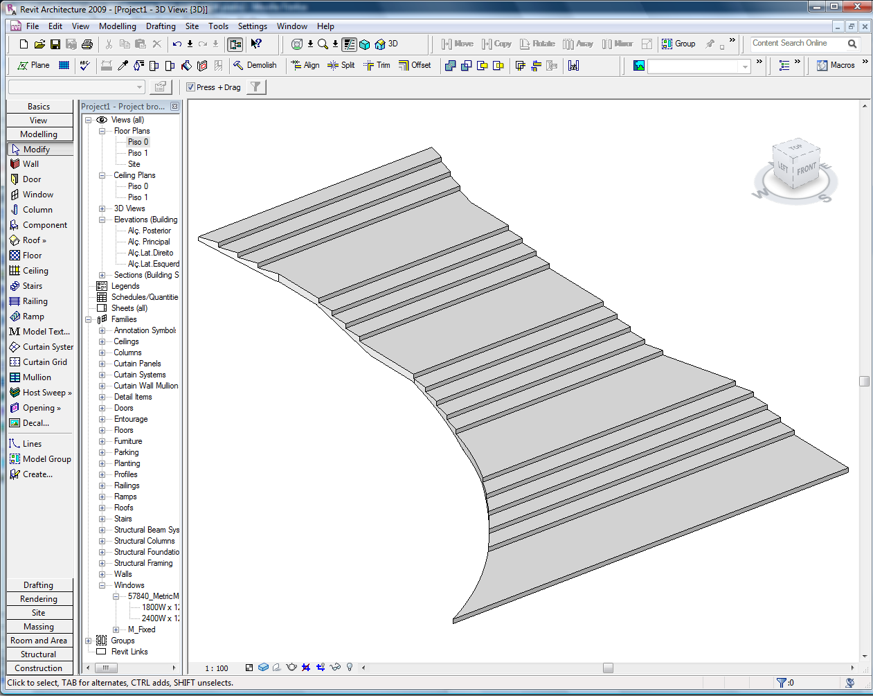

Wed, Apr 29, 2009 at 10:51:01 PM | Roof massing/auditorium steps
#13
Mufu
25 Posts
hey typhoon that one looks far much better but how did u do that i have got like two auditoriums and i have used the sfloor one by one and arranged it took me ages to get that, how do u the way u have done if the auditorium is goin from ground floor ot lower ground and plus the ramps int the side,secondly i got the fmaily of the chairs nwo when i place them it place them on the zero level of lower grounbd so the setaing appers all in one line when i go on section and try to move it just moves horizontally not vertically thank god for revitcity to come back online i couldnt access this site for like a week typhoon and now i am serous its curse urgent..if icould i could have just sent u my file and u edit the auditoriums for me Winking heheh
