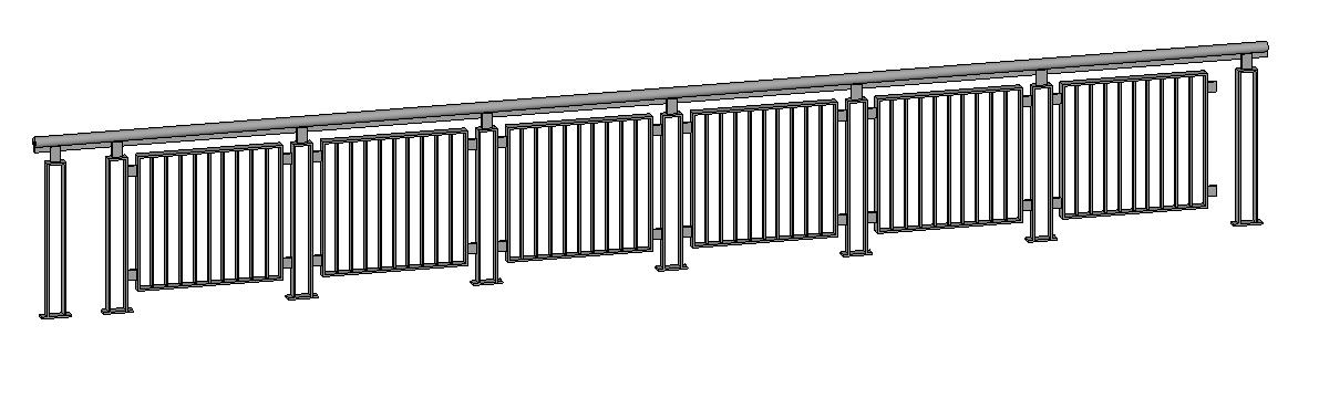

Is there any way to paramatize the spacing of baluster posts in the Railings Tool.  I'm trying to develop this railing (picture attached), with baluster posts and a panel system, and I cannot get the spacing to work out.  One would think that the baulster panels would attach themselves to the baulster posts and space themselves evenly.

railings can be pretty tricky, what I have done in the past on something like this is in sketch mode to split the "pink sketch line" at the end of that panel where the baluster is missing, then in your baluster dialogue tell it to place a corner post at each segment end.
I really split up my sketch lines alot to create my baluster spacing instead of that calculated crap.
