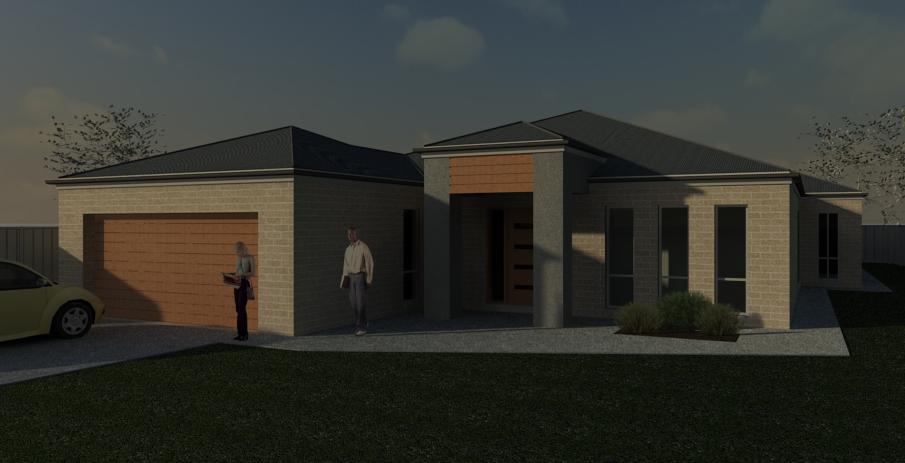

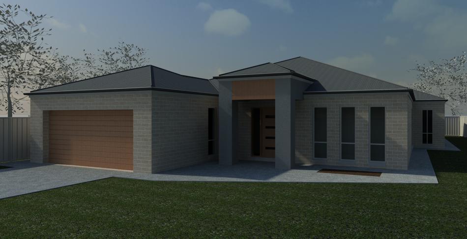

I've attached two images. One was done with the Render Quality Setting "Best" and the other with a customised Setting where I increased the "Refractions" and "Indirect Illumination Options". Am unsure of the materials used on these renders but am pretty certain alternative materials were used. At some stage today I will be ready to generate another render whereas I will use the wanted material swatches. I can then post the swatches used and the resulting render where you'll be able to spot the difference.

Sorry, which render is which? The lighter one is the one with the custom settings?

Hi mate.
The darker one has the custom settings. The lighter of the two is what results when I use "Render Quality Setting" set to "Best". Wasn't happy with the way it presented so I had a quick play with customising refractions, etc. I'm all new to this so at this stage it's all experimenting.
Still not happy with it. The render attached is one I did last week. We ended up using something (much to my disgust) but I've got a few more I'm working on now. Gonna change some settings and let it render over night and see what the result is in the morning.
