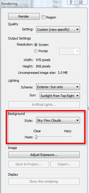

Tue, Sep 9, 2008 at 3:05:16 PM | Rendering Tab
Joined: Tue, May 22, 2007
5921 Posts
4 Stars: 205 Votes
"Where do I find the "mental ray" sky option?" - in the same "Render Dialogue" you have "Background>Style", see picture attached...., you also can (before goes to rendering) go to the TOP menu and in "Settings-Sun and Shadows Settings" and in there you can change the settings to "By Date, Time and Place" to create the "exact" shadows projection in your model but i think you must read the HELP tutorials...
Edited on: Tue, Sep 9, 2008 at 3:46:29 PM
