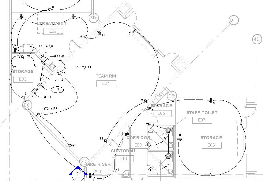

Good Afternoon, I'm new here and i was wondering if you guys could give me a hand.
Example:
Given a typical classroom for a middle school.  There are 10 or more receptacles that needs to be wired up using 3 circuits breakers on a panel (A).  How do i go about in circuiting all 10 receptacles using the same conduit and homerun, rather than having to create a new conduit and homerun for each circuit?
 Attached is a screenshot of the classroom im trying to work with.  Thanks a lot for your time and help.

 HLuu you might be able to use a j box to accomplish what you are trying to do here. Although I have asked a similar question a long time ago and never got a response. so this is somewhat of what i have been doing. what your going to run into is that and just like a dual ballast light, revit doesnt like it.

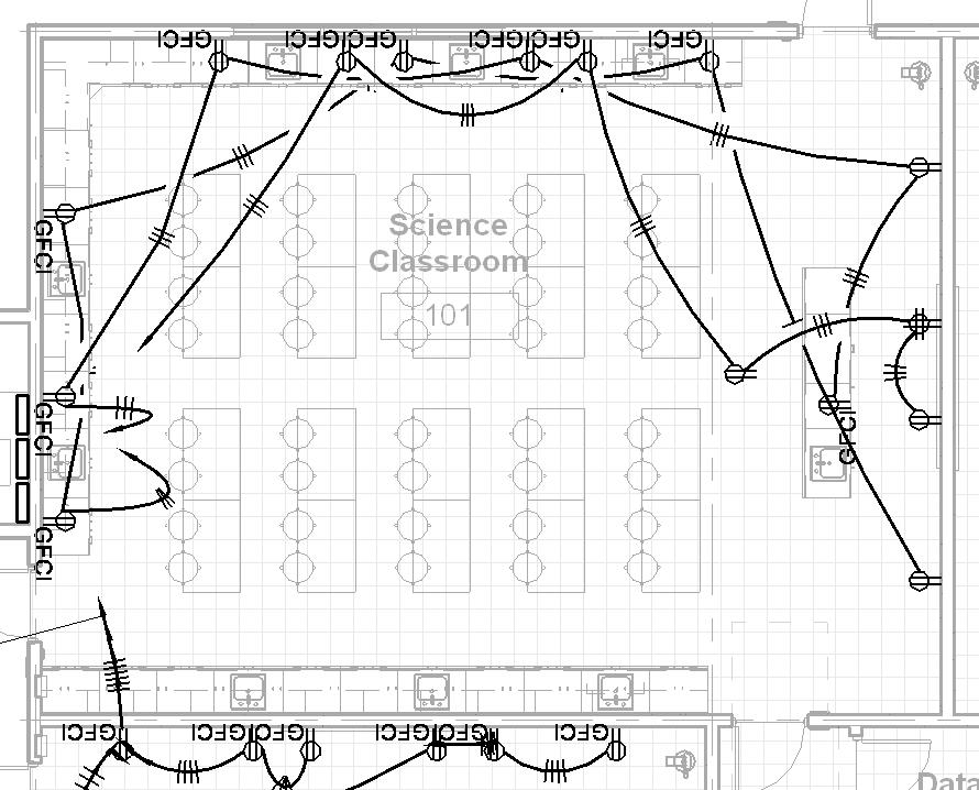

In order to wire your devices with multiple circuits you can't let revit draw the circuits.  lets say you have 12 receptacles and you want to divide them among three circuits like 1,3,5.  You select all the receptacles you want on circuit 1 and then connect them to the panel, and do the same for 3 and 5, dont hit the wire button after you connect them to the panel.  Select the wire tool and circuit them manually.  It works better if you are on wireframe mode when this is being done.  Also revit doesnt create the right amount of tick marks on homeruns with multiple circuits.

One quick warning,  if you use multiple circuits via one homerun, Revit does the following:
Draws a homerun arrow on the home run, for EACH circuit powered by that run (ends up with several arrows, one behind the next).
Draws a homerun arrow at the point of connection to other circuit.
And I've not noticed any issues with wire ticks, if you add in another circuit, the shared lines show an increase in ticks, but perhaps it doesn't do it "properly" so be on the lookout.
