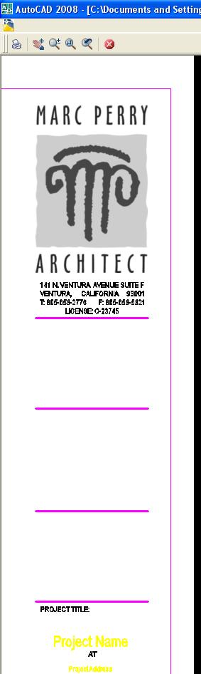

I would like to be able to export a title block from Revit (2009 version), for use by consultants who work in AutoCAD. I can do this by either A) creating a blank sheet in the project and exporting it, or B) exporting the titleblock directly from the family file and then entering the appropriate info for project title, address, etc Cryingsee attached files of Revit title block and exported DWG version).
 The problem is, no matter which way I do it any raster images inserted in the title block (namely, the firm logo) have a box drawn around them when exported. Is there a setting I can change so it won't put a box around the logo? I can't easily fix this in AutoCAD by deleting just the box because it deletes the entire image, and if I try to explode it the image disappears. Any help is greatly appreciated.

This I believe is an AutoCAD setting.  Imageborder

Open the Autocad drawing, type TFRAMES and it should disappear

Tframes worked.  thanks so much, that's exactly what I was looking for!
