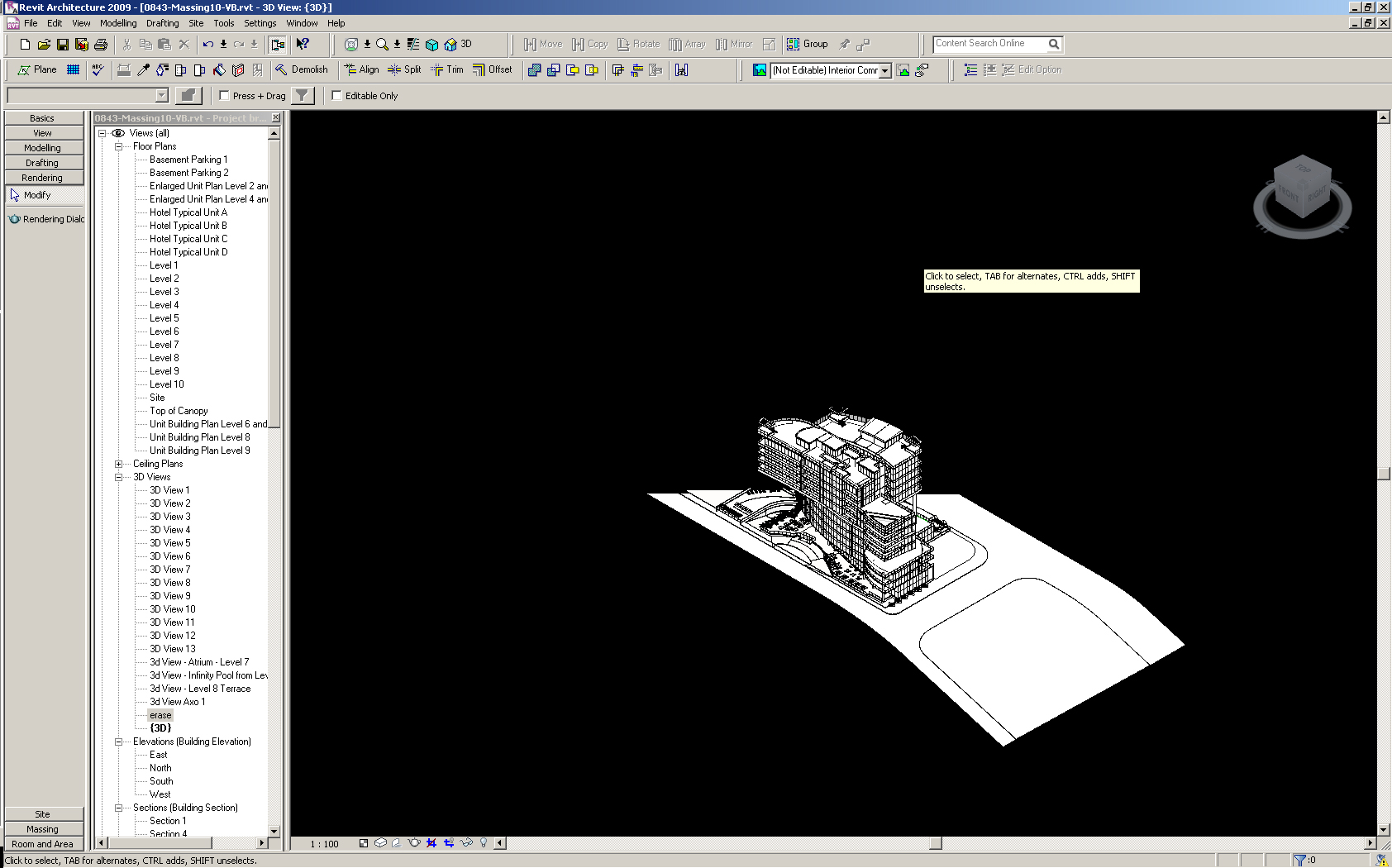

Hi all, as can be seen in the attached image we are having a little trouble with Revit Architecture 2009. When we select the standard 3D view in this model the screen background is black instead of white; however, our background option is not set to invert colors. All remaining 3d views (ones we have created and named) all show as the standard white background. Also we have tried deleting the 3D view and re-creating it but the background on this one view always shows up black.
Any help on resolving this issue would be greatly appreciated as it is not killing the model just extremely frustrating.
Thanks

Hell, it's wierd, i never see this issue before, did you upgrade the "Web Update 20080602_1900"? Any other 3D View it's like this or just this 3D view is with this background?

This problem has been resolved, thanks for your help. It turns out that the problem was a bad ADAC linked file, once the file was removed the problem went away. Still an odd glitch in the system.

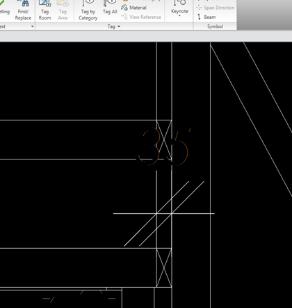

I am having a "Black Screen" issue as well. When dimensioning in a chain none of the dimension values show up until the dimension process is completed and the ESC key pressed a couple of times. I have attaced an image of how the dimensions appear sometimes.  ???? I know it's not a major issue but at the same time very annoying, especially when it works fine on another machine in the office.
