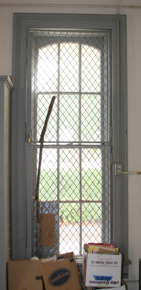

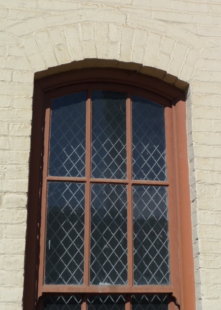

We're working on a historic brick building.  The windows have a brick arch on the outside, but a square top on the inside.  The inside head is level with the TOP of the exterior arch (the brick arch covers over part of the window sash.)
Any suggestions on how to model this in a window family?

Hi, do you have some photos for exterior and interior window????

Pictures attached.

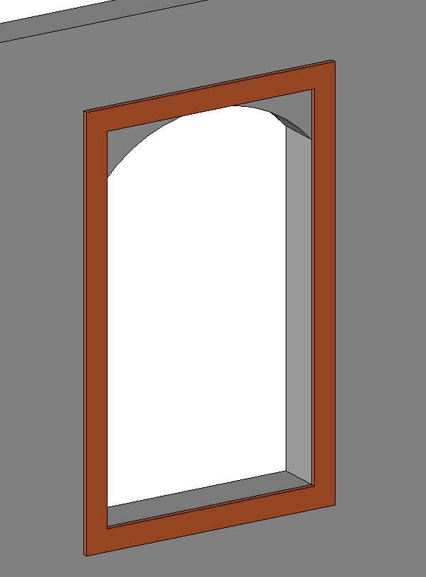

Hi, create the window Family with Trim like outside view and in the inside create the trim around with the net wireframe...
