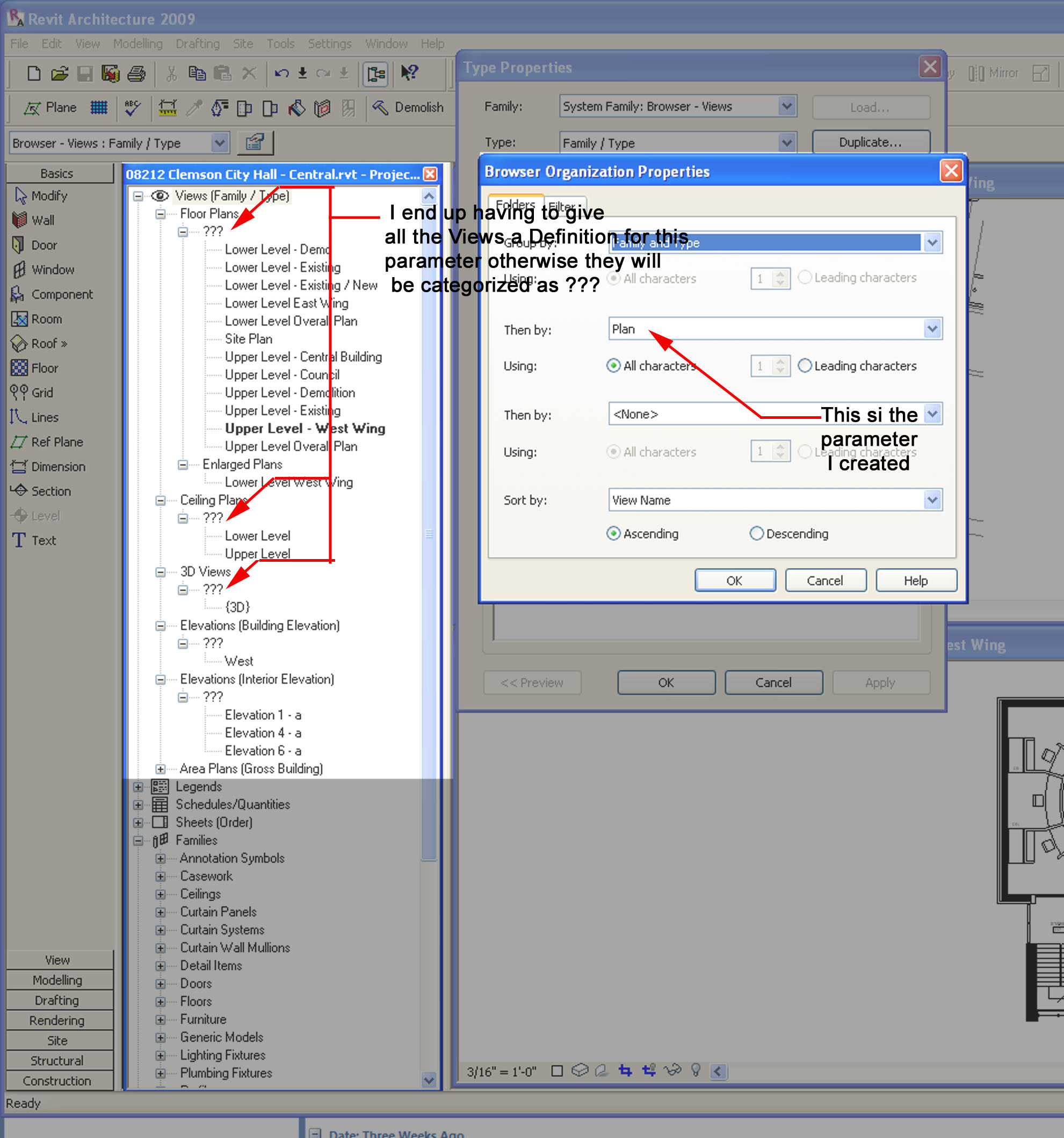

AGREED jreding.  I have the same issue.  If i dont fill out my paramter "View Type Group" then I get ???? for the empty ones.  the whole point is to limit the number of + lines I have to drill down into.
 What I did, was to fill that out for all views.  Even though I have a building section, wall, section, and detial section as different types for section family, I filled out my View Type Group.  For floor plans, I used Floor, Enlarged, Roof, and Site to break them out.
 I wish there were more grouping options because 3 is not enough.  My first group is by usage - schematic, presentation, production, working.  The second is by family and the third is by View Type Group which I created.  This works great on one single story building.  We do school campus work.  I would like to further group by building and by floor.
 See attached.

YES - thanks WW - I thought of that part just when I hit submit.  I have both the View/Sheet Purpose Group and the Sheet Type Group in my view template - this way I only have to set default view template.  then i apply default view template to all the views and they get their names, sort, and the world is a better place.
