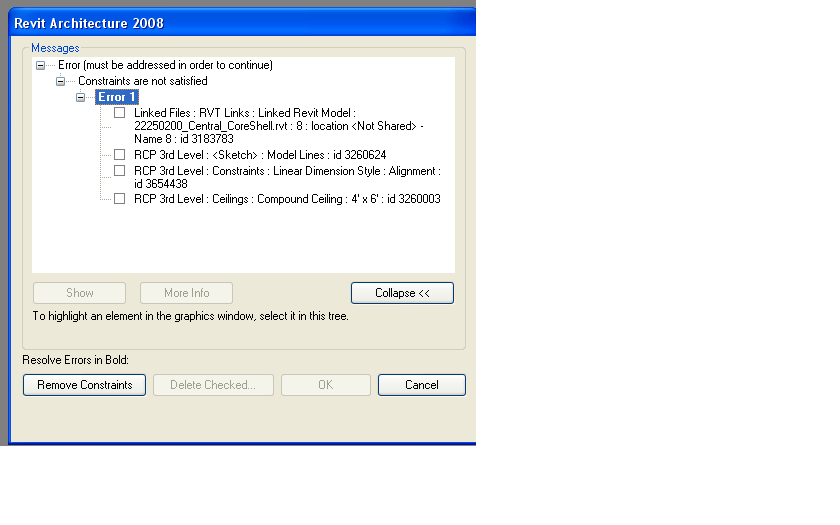

Hi All,
 I'm getting an error when trying to open my local file which tells me that Constraints Are Not Satisfied in several locations.  The only way I can continue to open the file is to remove the constraints.  (I made a screenshot of the errors and attached it to this post.)
I would try to locate the element IDs and fix the issue, but I can't get into the file without removing the constraints.  If I do remove the constraints and then try to find the element by the ID, I get an error telling me it can't find the element.  Has anyone seen this issue before?
Thanks, Jim
Wed, Aug 27, 2008 at 9:27:55 AM | Constraints Are Not Satisfied when opening file - Revit Architecture 2008
This problem has occured because someone created ceilings using a linked file.  The ceilings are constrained by the linked file which has obviously changed.

Thanks for the quick response on this.  Should we use a room separation line to avoid this situation in the future?
