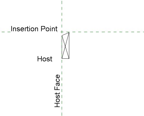

.....................you got me this far and now I have another problem.  I keep getting a "could not create fascia" error message when I try to use this profile (which is now available when hosting roof sweep) as an attached sweep.  This is a 2x6 vertical fascia board that I am attempting to attache "under" the edge of the roof.  Am I in one of those "you can't get there from here" moments?
Wed, Aug 27, 2008 at 11:04:39 AM | Help! Can't seem to find how to add new roof sweep profile.
The insertion point is the edge of the roof.  If you want the sweep located somewhere else, move it in the family.  It does not have to be at the insertion point.

Did you try to delete those "CROSS LINES" inside the profile?????

The stupid crossed lines was messing up my sweep.  Thank you!!!!!!!!!!!!!!1
