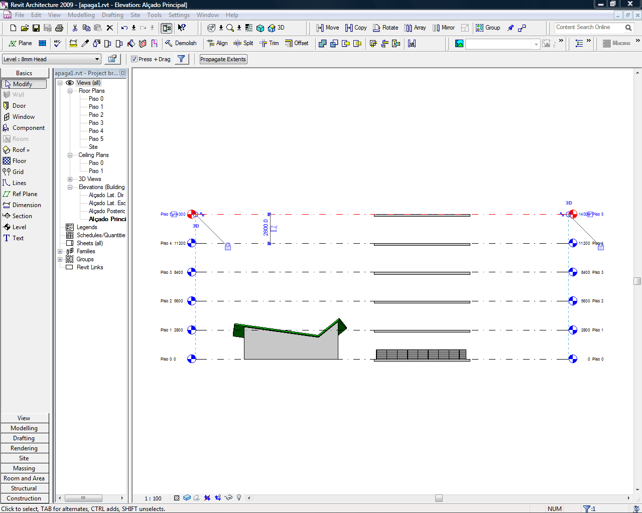

Hi, YES it's possible, you can create a annotation family and use them in your project, pick in the Line Level and go to properties and change the "Head" to the new one... see the image and i put a Annotation family to you, edit them and change if you want....

Hi, now what you want to do is: File>load from Library>Load Family and choose the folder where you save the family i send you (must save in "Metric (Imperial) Library - Annottations), after loaded pick in the level line, go to properties and Edit/New, then where is "Symbol" choose the family name you just load to project, that's it.... if you want to change anything go to File>Open>Metric (Imperial) Library - Annottations>Mlevel_Head_-_Circle2.rfa, then change, save and "Load to Project"....
