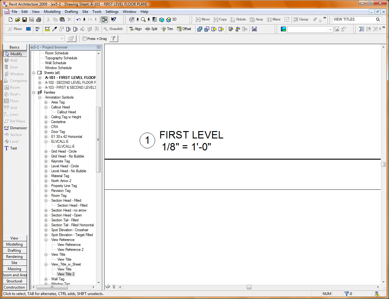

Anyone know to fix view titles w/o their leader line? See attachment.
Thanks in advance!

Pick in the view, go properties-Edit/New-Show extension Line...

Thanks again!  You know I really need to just starting thinking "GO TO PROPERITES" and it will solve a lot of things.. :-)
