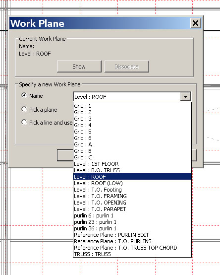

I am new to Revit. I understand work planes (creating, naming, visibility...) but HOW do i delete a workplane that i have created when i no longer need it? Is it me or is this less than straightforward? Thanks in advance to anyone who can help.

Thanks. Created or set...Revit appears to be keeping a record of all the work planes i have used.
let me elaborate a bit. i have created work planes for creating 3D geometry of "in-place families," etc and it seems REVIT has even created and named some other work planes after I have picked faces of 3D elements in my model(see attached jpeg - e.g. "purlin 6", "purlin 23", etc). Now these work planes appear in my ever growing list and i dont need or want them anymore....
 so how do i tell REVIT to delete them so that my list contains only the ones i want and am likely to use again?

I don't think you could ever purge a "reference plane"? The only way I've ever been able to get rid of them in your pull-down list of work-planes is to FIND the reference plane, pick it, then delete. It will automatically disappear from the list after this procedure.  I've had problems when a reference plane was created at a weird angle on a section that was eventually deleted. With the section gone I could no longer find the reference plane to delete it.  It drove me crazy!!!

Purge Unused will not get rid of Reference Planes, and after experimenting I found it will not remove unused Work Planes from the drop down list either. The only way I found was to delete the element that defines the work plane. Seems like a bit of a flaw.

Thanks. Agreed - this is cumbersome. You have to remember which view you created the reference plane in...and then delete them like they are objects. maybe its best to encode more information in the new refernce plane names give that we assign like "temp" and the name of the view in whiich they are hosted in e.g. ref plane name:  "temp-east elev-name"

my work around here is create new reference plane. Then select that plane, right click then select all instances on entire project then hit delete..
