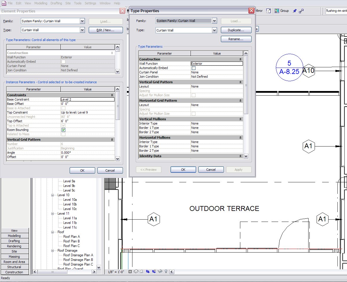

We are running into weird glitches here...
We have a curtain wall that we need to change a few mullions, glass panels, move doors, etc...
It was originally pinned, but now we "un-pin" anything, change it, and for some reason, when we pin those objects they revert to their previous state. Sort of like doing an Undo. (Didn't happen in 200Shadey
Are we missing something here? Or is it a Revit bug?

Can you put a screenshot with that "Curtain Wall" selected and where we also can see the properties of that?

here are the properties...
you can see two offset panes of glass on the latch side of the door, that is what I'm talking about.  No matter what you do to them, they come back... And can't pin them after correcting anything, cause I'll undo everything....
It is driving me nuts!
I had some storefront in the project, and it almost make me kick this computer with the reappearing grids and unexpected changes... I know it must be the default settings, but it is just not too intuitive.

Your problem is exactly as I suspected.  You used REVIT's storefront which gives you pre-defined grid spacings.  It is far easier to use the curtain wall and establish your own grids.  In order to modify this, you have to set a switch that turns off the automatic spacing on each grid segment that you want to move/delete.   I don't remember  where it is right now.  I may have time tomorrow if nobody else  tells you how first.  Unless this is a very big area, I would problably swap it out.

If you see the picture, it has all the curtain wall properties listed in the help file, so I guess it must be a curtain wall and everything is set to "none".  Yet some glass panes get weird offsets and some don't although they are the same type.

Our problem is that REVIT choose to include an automatic storefront/curtain wall system in their package and they call it storefront.  As we all know, storefront systems and curtain wall systems are not the same but in the REVIT world, they use the same components so they are interchangeable - right?  Yes but...
I think we should correct our terminology.  In REVIT, the differnce out of the box is that the "storefront" is an automatic system.  All of the components and spacings are setup in the wall type.  The other system they call curtain wall is a manual system.  You have to add the grids and components to it.
You have used the automatic system.  So, whever you try to change it, REVIT trys to fix it and make it conform to the type rules you either set up or just accepted by default.
To fix your problem either
  1. redo it as a non-automatic system
  2. to move grids - tab in elevation to choose the grid line(not the systemm, panel or mullion) - goto the grid properties and switch the type association to independent.  Now you can adjust them.
