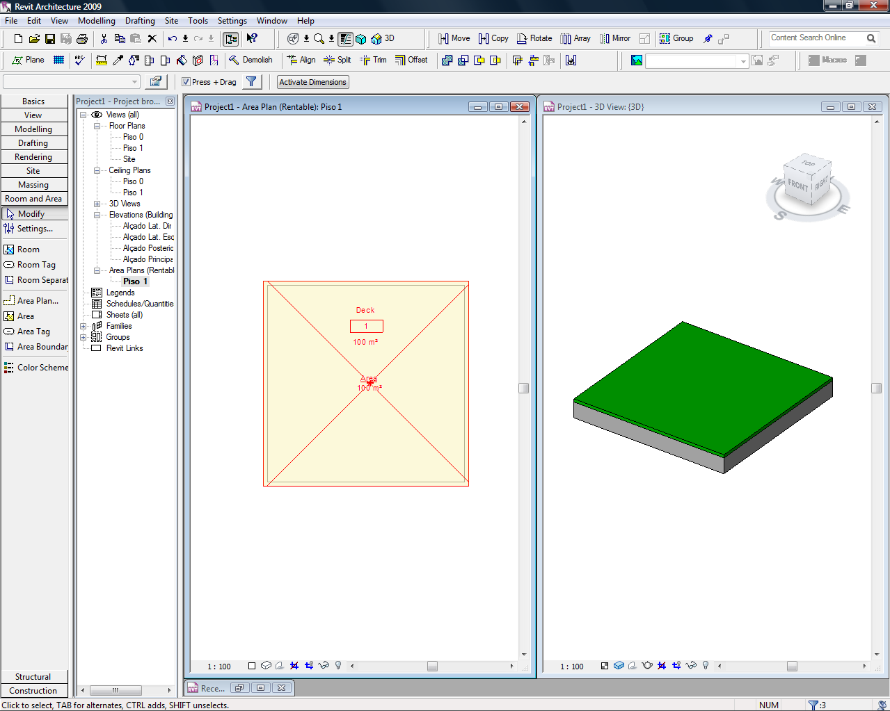

I'm working in Revit 2009. I have rooftop decks and want to make them rooms with square footages and all. The problem is that Revit does not recoginze the decks as being surrounded by walls and thus cannot recognize them as rooms. I can't change the cut plane of my plans because other fixtures (such as sinks) will be cut through and not in elevation. Does anyone know how to make rooms for the exterior?

"I can't change the cut plane of my plans because other fixtures (such as sinks) will be cut through and not in elevation." You can create a "Plan Region" in that zone and change the elevation to what you need to see...

1.  If you insert a room (even off in space where it will become a square, unattached) you can modify the base offset to be lower.  The Comutation height, if set to autpmatic should find any wall, no matter how tall (I did it with a wall 1" tall).  Make sure you are adding the room names on the level of the decks.
2.  Use room boundary lines.

Just use room seperation lines to define your space.  I do that all the time for exterior spaces.

WWHub's and my #2 suggestion is the workaround and will suffice.  However, I would urge you to look at your settings.  If there are walls defining a space, the rooms should be automatic.  If they are not, then something is wrong with either your model or settings.
I would hesitate adding a lot of room seperation lines only because the model could get cluttered and with walls in place you shouldn't *have to* add RS lines.  RS lines, are the "quick fix" if you are trying to meet that deadline, though. Smile

Thank you both for the suggestions. I'll try everything out. I was actually trying to do separation lines (I thought this was the only way to get around the problem), but it never worked. I'll let you know how it goes.
Thu, Aug 21, 2008 at 12:50:22 PM | exterior "rooms"
The room seperation lines will work but you must be on a level that the view is associated with.
Something you may not know. All items like doors and walls have a room bounding switch that you can turn off or on.
I must also add that if you have to create a level to host these lines, you can always turn the level off in all views.  It can be just there to host your lines - not a true building level.

All: I have been trying the many suggestion (which were much appreciated). Unfortunately the only way I managed to make the decks shows up was by using the room separation. Thanks for the help. I'll keep trying over time and let you know if things change!

Laura, if you can post your file, or a smaller version of your file with just the roof decks and walls, I can take a look at it for you.  I'd be curious myself what the issue is, and to verify what is in my head is what you are asking..

Lizard, that's why many times i said "Can you put some screen shots to figure out what do you need?"
