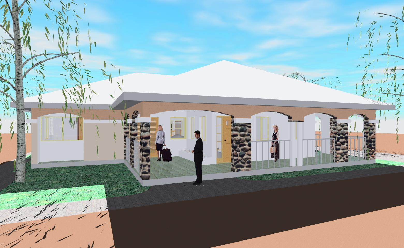

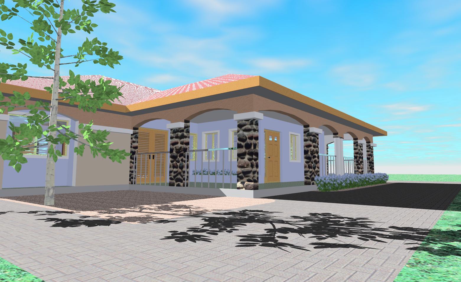

Please i need someone to help me with my wall wrapping.
I created a 225mm wall that has 3 layers: Exterior finish,  then i split the wall and added another layer which i assaigned to the lower part of the the wall so i could have a stone finish below and then concrete above.
Now my problem comes when i created an opening in the wall and the opening was wrapped with the concrete even to the layer below, then i proceeded to turrn off wrapping for the concrete layer but now the stone layer wraps all the way to the top. Please can anyone help me with this

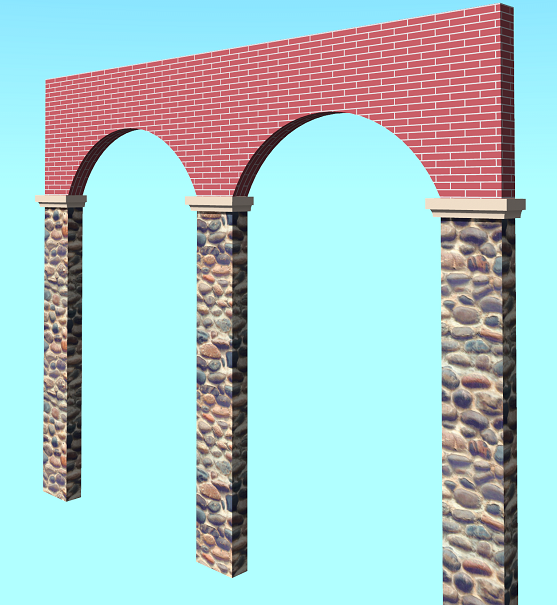

Hi, if i had to create this model i don't do it jut like you do, i just create that "Columns" with a material, then above them create a wall with different material and edit that wall and create those "arcs" (don't use openings) and after that i create using Moddeling - Solid Form - Solid Sweep that sweep around the columns with a 3 material, with this way i don't have to split walls, duplicate the walls with another name, wrapping the walls i check the interor or exterior materials and so one, see image attached...

Now to solve this, you must use the "paint" tool, chose the material you want and pick in the face you want to aplly with that material... I think this is the most easy and quick way to solve this issue...

thanks bro u sure are one wiz kid. I used ur later sollution i applied a paint to the face, that solved it, but i would like to know how u made the sweep go round ur wall i need a little more details, thanks a lot agian. ur explanation was helpful, i guess ill try out ur method in future projects.
