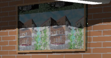

I am"playing" with masses in RAC 08:
I made a rectangule and then a frame. In th rectangule I want to show in the rectangule a phto.
ISo I went to Materilas and created a new texture with a phto. Then I aplied it to the rectanguele but when I render that, The image doesn't match. I also try keeping "aspec ratio"
What do I have to do so that it fits right?

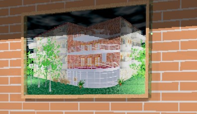

If you want pictures to show when you render, use a decal. You can easily change the decals height and width to match whatever frame you make.

Yes Timbo is right use the decals for picture. u can find the decal from the Modelling Tab of the Design Bar.

I didn't know that tool!
Now I could do it!
Thanks a lot!
