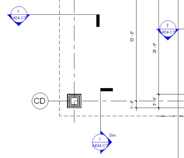

Section tags appear to be a System Family in R Arch 2009, and as such are not editable.  Is that right?
I've got text spilling out of the bubble because this project is going out in two packages - core & shell / tenant infill, and am stuck with the sheet numbering convention.  See the attached image.
Any work arounds?
Thanks!

You can edit the section head.  Look in your browser under annotation families.

Yar!  Thar she be!
Thanks WWHub!
