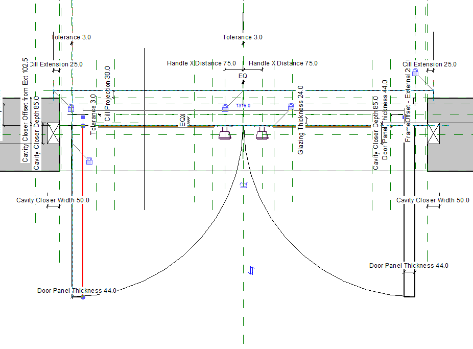

Okay I have a question as to why the storefront single-glass door I added to this storefront assembly I made is appearing the way it is. (See attached picture of problem)
Anyone know how to solve this or maybe this happen? I added the "Curtain-wall: Storefront"  then placed the door through the load command.  Any help would be appreciated thanks!!

It looks like theres a problem with the family and its placement.

Hi edit the family and check if the Symbolic/model lines (opening, panel, swing... "projection"Winking are locked to the ref. planes....

Thanks for your replay, but I can't find the location to check the model lines once I click on "Edit Family" for the door?

Hi, when you pick on the door and "edit Family", go to "Floor Plans-Ref. Levels" then you have the "Symbolic Lines-Panel (Projection) and the Plan Swing (projection)", when you pick in one of them  appears the locks like in the image attached, if any lock is "open" you must closed...

i think your door swing lines are locked to the face of the wall in the family.
