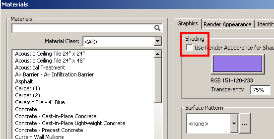

We are having issues with the way walls and elements are displaying in Revit architecture 2009
The material used in the walls has a Graphics Shading setting with a colour of white and there is no surface pattern. The elevation especially shows that the shading is definitely not white.We need the views to show other elements in colour (eg mechanical ducting) so the hidden line setting for the views is not an option. (Note: the shots below are a dummy test project file and not the actual views, but they illustrate the issue)

If you are using REVIT 2009 are you aware of the setting in the image attached below? This will effect the color of your shaded view of the material based on the 'rendered' settings. If checked off, the material looks to the 'rendered' setting for it's shaded color.
