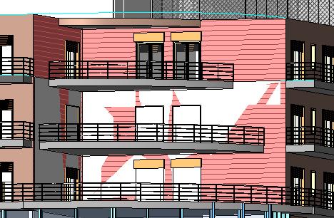

I show you my problem:
 As you se, there is a part of the wall wich shows blank (without material) but it is indeed applied.
This also happens in any way, any quality and style view possible and also if I render it.
What can I do? PLease, I need to print a 3d view tomorrow.

Alc, don't you have 2 walls in the same place? In that level select with crossing that wall, then go to the "filter" and check if there is one or more walls in the same place.... in the image we can't see the doors too...

lol
That's true! I had 2 walls
thanks a lot, again Typhon!
