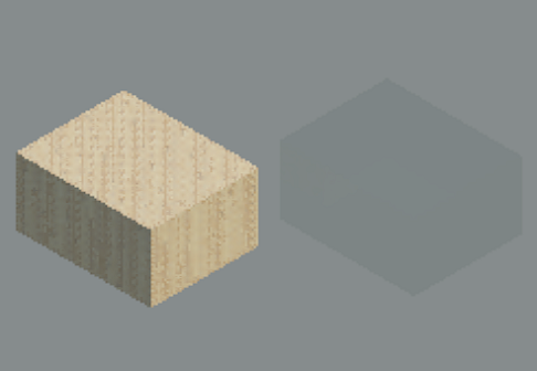

Mass object not showing when i render

Rendered Massing will not show up properly until you give the mass a 'material'. You can either a) edit the mass, select it and change the 'material' properties or b) use the 'building maker' tools to add walls and floors and roofs to the mass surfaces. Then have a look at the 'materials' of those new objects before rendering. Rendering is all about 'materials' and 'lighting'. See attached image of one mass with ''Wood Flooring' material and one with 'default mass' material.
