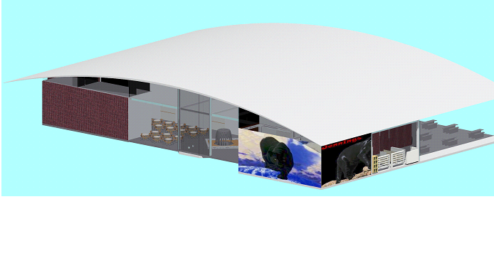

Is there anyway we could put a picture (mural) on our curtain wall.

Yes. Set the work plane to the curtain wall panel you wish to place the mural on. Then use the decal tool to select the appropriate picture, size and location on the panel and click to place. HTH.

We have the murals on, but only half of one shows up. Help Please!!!!

Never mind...fixed it. There were two seperate cutain walls attached
