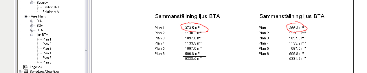

I have an area type schedule on a drawing sheet that shows building gross area and such. But when I update an area plan, the area only update in the real schedule, not on the schedule thats on a drawing! Scary. This is fixed when I restart Revit (Architecture 2009), but I feel I have to be able to trust revit to always update by itself...
Anyone else had this problem or know a solution?

Thats what i thought too. I recreated the problem and posted a jpg of it. I changed one area plan (circled in red), the list on the left didnt change so i dragged another copy of the exact same schedule to the sheet. As you can see that one changed, but still not the old one! Now I restarted Revit and then they both look identical!

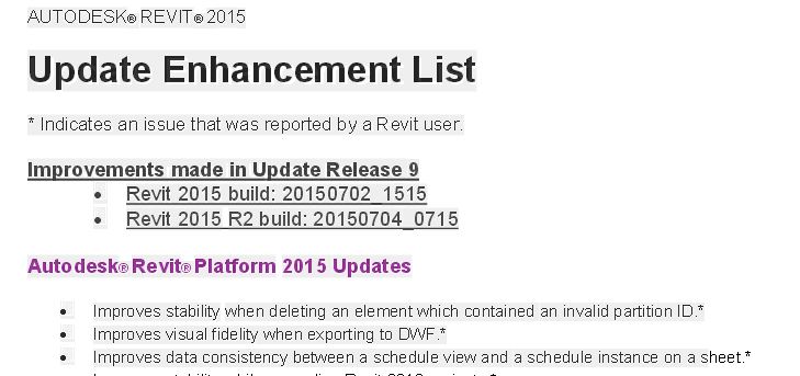

creyc, You write: "...Running UR13 with all current updates..."   What is UR13?  Saying you have all the updates does not make it so.
Below is a clip from the Autodesk site that says they "improved" the consistency of data from schedule to schedule on a sheet and they show the proper build numbers for 2015.

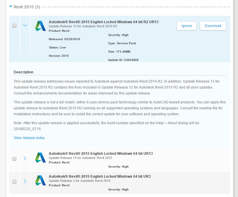

Ah sorry for using the somewhat confusing Autodesk abbreviation.  'UR13' just means "Revit 2015 Update Release 13", which came out Feb 29th, 2016.  At the time of my post this is still the most current update available through the subscription center. (see screenshot)
Interestingly those release notes you pasted for UR9 certainly sound like they have already addressed this issue, which should have then been rolled into UR13 according to their readme:
"This update release addresses issues reported to Autodesk and contains the fixes included in Autodesk Revit 2015 Update Release 1, 2, 3, Multi-Category Schedules Hotfix for Update Release 3, Revit 2015 R2 for Subscription customers, as well as Revit 2015 R2 Update Release 5 through 12."
Hopefully I can wrap these 2015 projects up soon and pray this isn't an issue in 2016, as it's quite discomforting not being able to trust your schedules to update properly.
