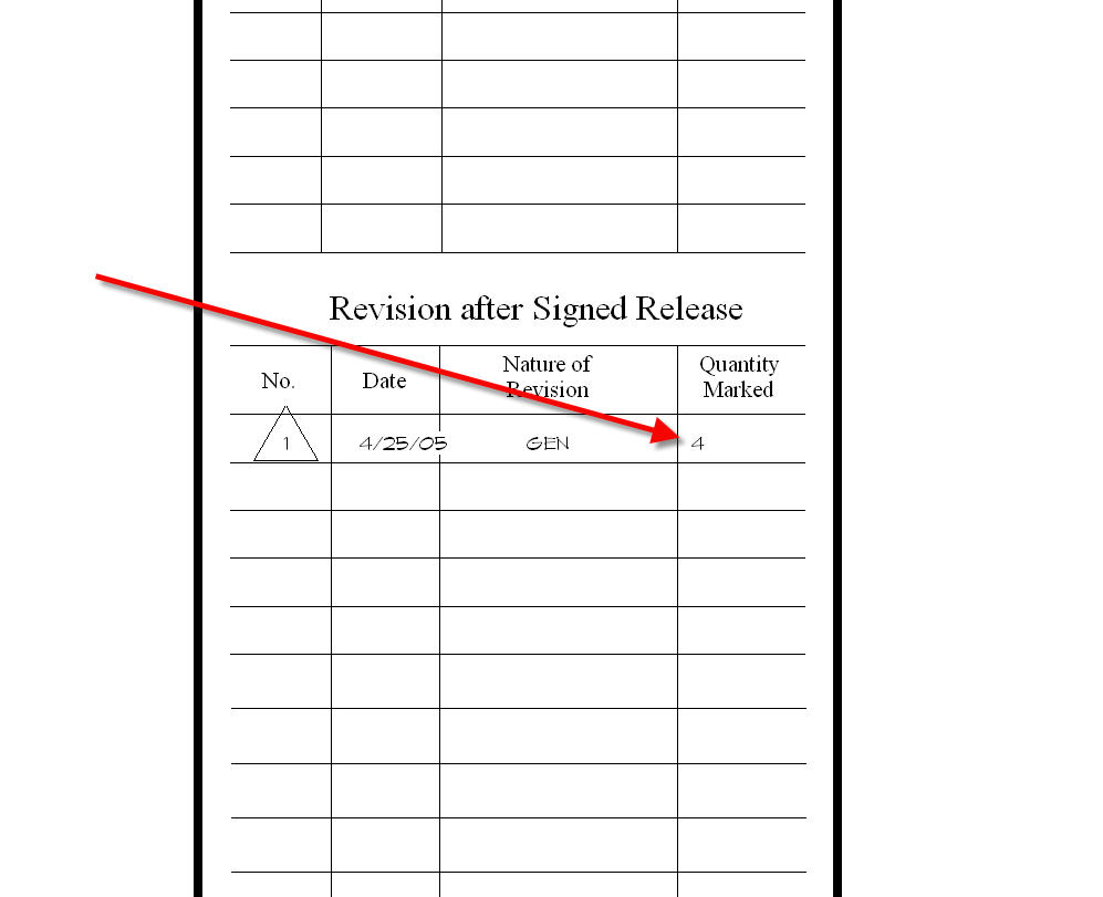

Can the Revision Cloud schedule show & calculate the total Revision in a column? Not just as a line of its own at the bottom. See attached jpg to see example of how we want it to look. Thanks

Not that i know of. Personally i found the Revision Cloud Schedule useless as our office convention is to use letters as opposed to numbers and also to have the the schedule grow from the base. We still use text and will continue to do so until this feature is improved. So i'd suggest just leaving a column here to add a text value. HTH.

Yes after a closer look I have come to the conclusion that the Revision clouds are useless for us as well! We like to erase the last revision bubble while leaving the tag and you cannot do that. Oh well it would have been nice!
