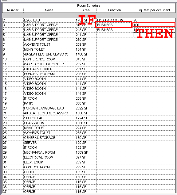

I'm using Revit 2009 and have a question about forulas and schedules. Is there a way to define an if / then function. Take a look at the attached screen shot. I would like to somehow link the "function" field to  the sq. feet per occupant field. If I choose a function, I would like a sq. foot per occupant to automatically be selected for the sq. foot / occupant field.

Unfortunately you cannot include text parameters in schedules.
The best you could do would be to use a number of Yes/No parameters and then create a calculated value that reads
IF(BUSINESS, 100, 0)
Where BUSINESS is a Yes/No Parameter
