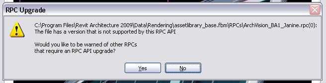

hey guys, i'b busy with a new project, got hold of some male & female shopping rpc content. now i want to use it in 2009. tried to copy a file into the RAC2009 library where the existing rpc files lives, but if i restart RAC2009 i get this message:
how do I go about achieving what I whant?

as warning says they are the wrong format there are different types of rpc content. go to archvision web site there i a bit of info there about what types of rpc's can be used by different sioftware
