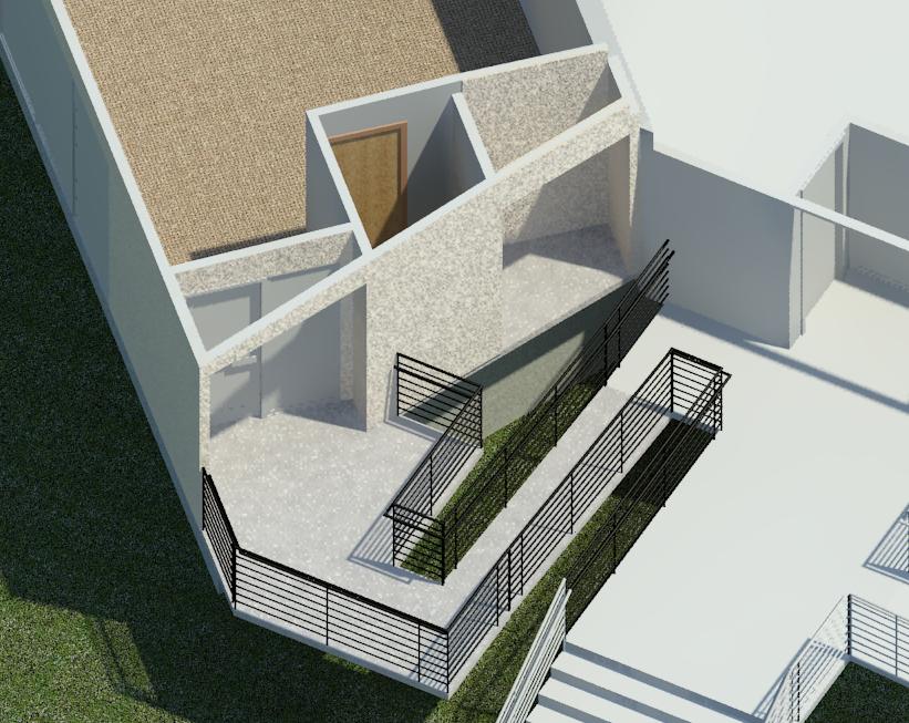

Thank you both so much for replying! But neither worked.... I will attach an image so that you can see what's happening. It's quite frustrating since everything else is starting to come together so nicely.

Is that a door/window family or a curtain wall?  Is it all the glass in your project or just the glass in this family?  Finally, if these are families, were they created in Revit 2008?
The screen shot you are showing me indicates that the material being used for the glass in this family/wall is not set properly.  We just need to find out which material it is trying to use.  The fact that the frame/mullions of the family/wall are also a generic grey tells me that that material is not rendering correctly either and that this may be a family that is calling on accurenderer materials.

That may be the key here! I don't think the family was created in 2009. I have checked the materials and they are the set to the same materials in the family as they are in the building model. If it searching for accurender materials, how can I fix that so the materials will render correctly?

The 2009 don't accept "Accustudio.mlib" like 2008, so i think you must assign new materials to the objects you have with Accurender materials... It's a pain in the curse i know,i pass by that too....
