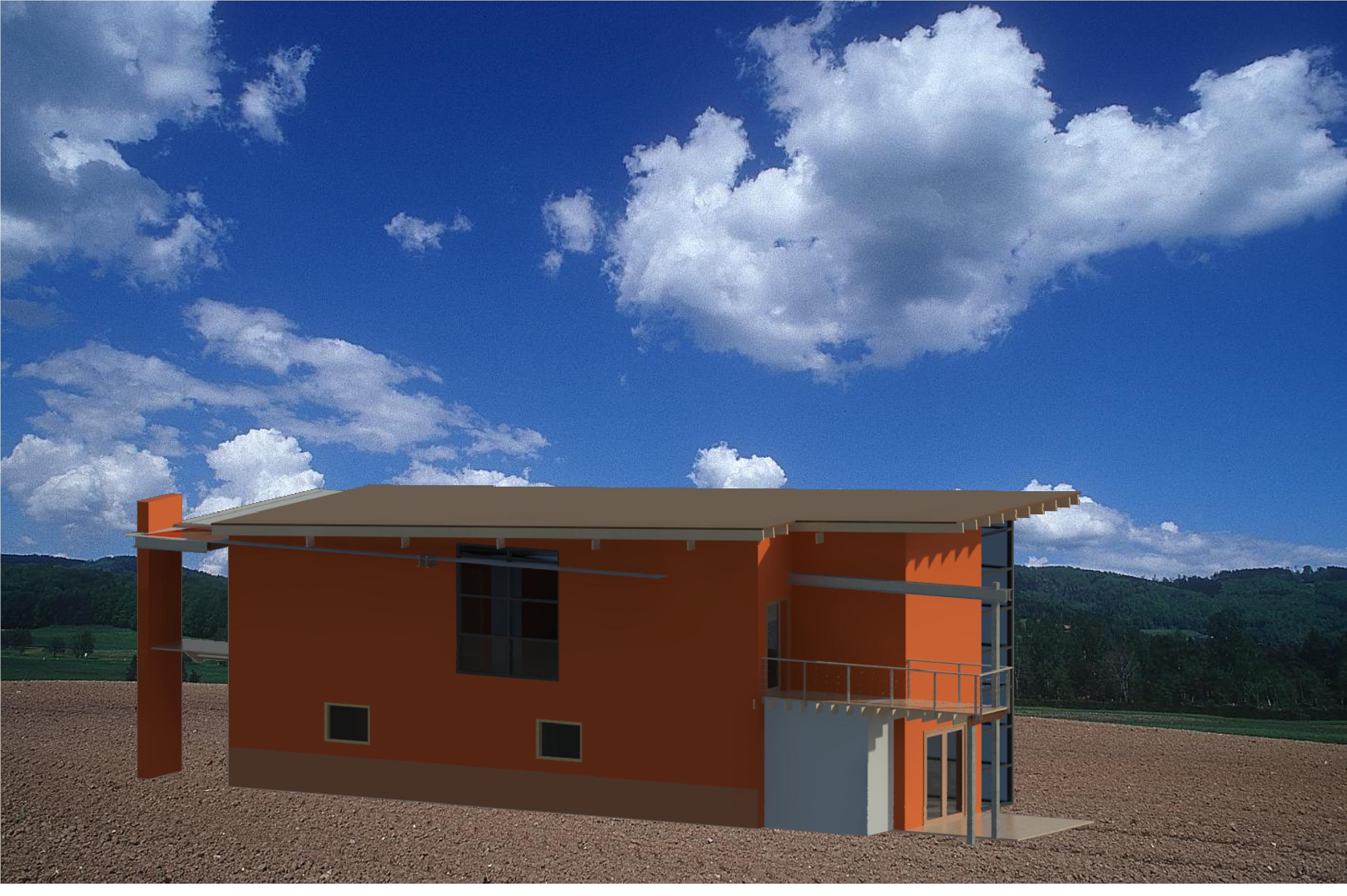

I'm about to write up a tip on this for revitup as a lot of people ask this question... but basically render you model and export the image as a TIFF.
Then create a drafting View and bring in you background image and then also the render out tiff of the model (tiffs render without the background being white)
 You can now overlay you model tiff on the background image in the drafting view and then drag the drafting view onto your plot sheet...

No worries... sometimes it just requires a little laterial thinking with Revit.... the only issue is a)trying to get the images to look at the same perspective and b) no shadows on the ground from the revit model... but it's better than nothing..
I've attacehd a quick example of what one looks like... and no Photoshop required :o)

What about the shadows?
Can't I include in the model a "piece" of ground (with the shadows) that "matches" with the ground image?

Yup you sure can... but you just have to try and align the terrain with that in the background image else things don't look right... it's not the best solution,  but it's better than nothing.... the other thing that does work is to create a very large wall or something behind your model and then paste the background image on as a decal..... just another idea..

Good idea (the decal) but I think the first one works better. I'm good with plants, etc, to disimulate the "unions". Besides, I can use the ground material scanned from the backround image (I used to do it with AutoCAD)
