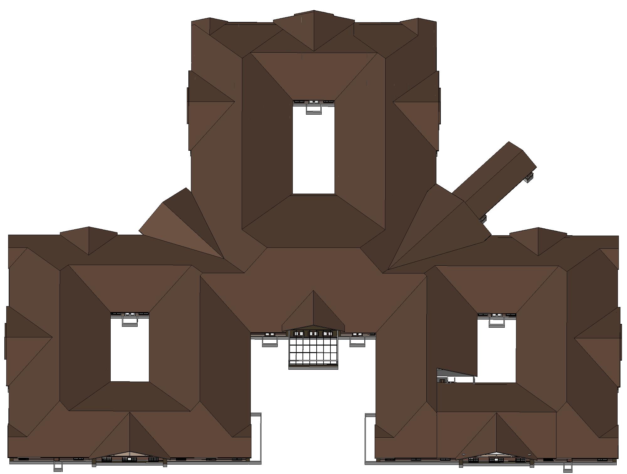

I seem to have gotten the roof shape to work....however I'm having an issue with lines showing up on the exterior of the roof where the two different roofs were joined.  I did join geometry....and still have lines and hatch issues on the exterior.  Some of the roofs I've joined geometry on work, and others don't.  I have attached a picture of the portion of the roof I'm talking about.  My problem started because of the courtyard in the middle and not being able to make a roof in a loop.  Is there an easier way to make a single roof while leaving a hole for the courtyard?

Sorry, but you picture attach it's to small and whit this i can't see what's the problem, can you take other image "Closer" and tell where is the problem??? i can help you but i need to see where/what's the problem, so i could make you a video for this....

can you click on the picture I attached.  When i do it, it gets big enough.  You will see that there are lines on the hip portion of the roof that I would like to disapear...

Ya you have to edit both portions of the hip roof.
Both portions need to be cut out of eachother, and then the lines will not be there

I still am not able to get it to work.  Notice that the gable on the lower left work and cleaned up fine.  I did the exact same thing on the lower right gable....doesn't work.  My error messages say can't join because of circular references...and also when I cut out both roofs to match exactly, I get the error "misses target" when I try to join geometry.  It's frustrating because it worked perfectly on the opposite side of the building.  Any other suggestions?

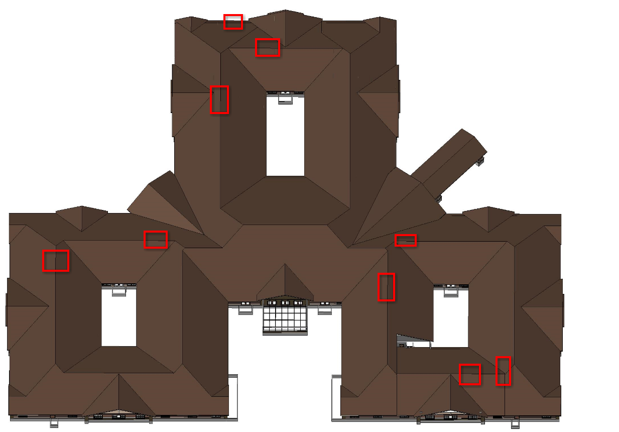

Well, by your pic. and i think it's a TOP view, i see something i put in red and it's like when you create that roof you miss the right point, it's look like "it" are with some rotation to the right, i think you must check that roof, "Notice that the gable on the lower left work and cleaned up fine.  I did the exact same thing on the lower right gable....doesn't work.",did you do a Mirror Left to the Right? "My error messages say can't join because of circular references...and also when I cut out both roofs to match exactly, I get the error "misses target" when I try to join geometry" because i think they aren't in the same elevation, you can check that with some sections views, only seeing the model i can tell more about this....

Everything was the same elevation...I think the jpg was just a little distorted.

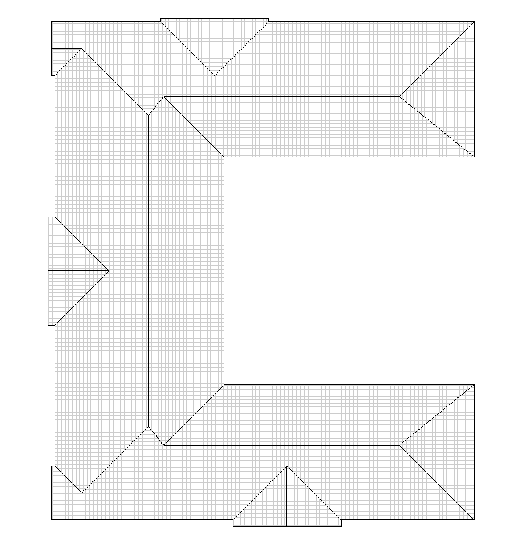

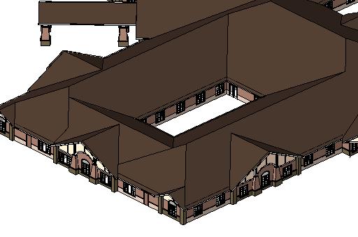

I've got my roof looking right now, exept for one last problem.  The area in the red box wont line up.  My 2d roof lines line up, but for some reason now the roof has an elevation change.  please see the pics.
Sorry for all the questions....this is my first revit project....and thank you for your help.

Hi, i try to recreate that roof in the problematic zone and like you can see in the pic. attached i don't have this problem, i don't know how do you create that roof and i can't see by your images all the properties of them, like slopes and so one, like i told you yesterday  "only seeing the model i can tell more about this...."
