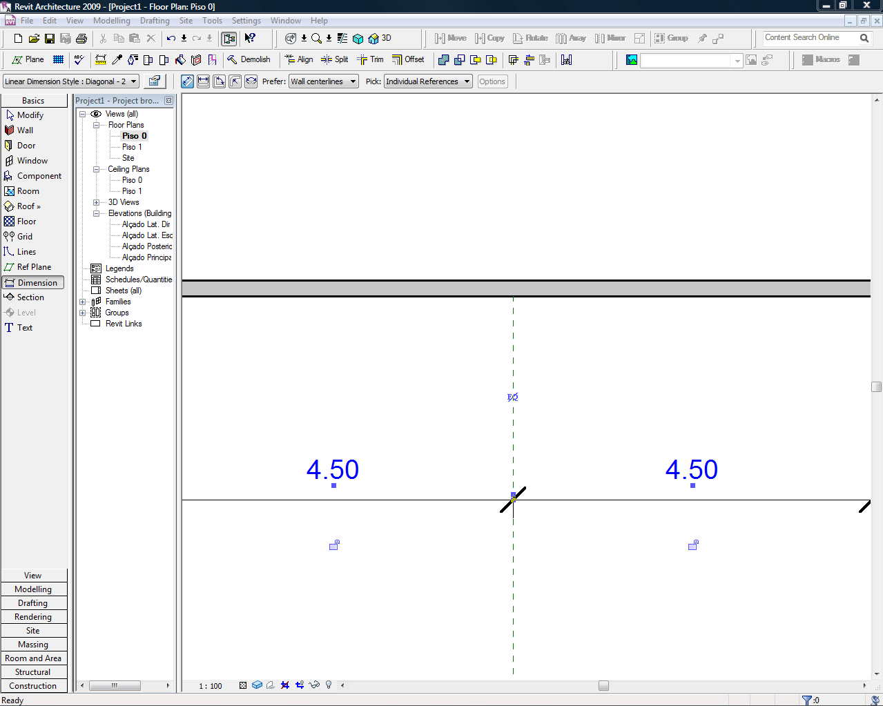

I am trying to do a tutorial in 2008.  I am doing the stepped footing tutorial.  It is asking me to put on two dimensions and then click the eq symbol at the right.  I can not for the life of me find this symbol.  I have no idea on how to get this, i have reread the dimension theroys about a 100 times now.  What am i missing?  Yes i searched help.

pick in the "EQ" blue... on top dim.

thats the thing, i dont get that eq symbol.  no matter what i do i cant get that eq symbol by the way the tutorial or the essentials book says. But....
I erased the dimensions, clicked the center line of the three, hoovered over a dimension symbol that allowed me to make the temporary dims to permanent.  Then it showed the eq symbol.  I even went to another system running another project and it too doesnt show the blue eq symbol when i tried to recreate that step from the tutorial.

Hi, see the video: http://screencast.com/t/7qArzlKuy1

Hi..just wanna ask if u were able to find a n answer to your question? coz im having the same problem too right now.
:-D...i was creating a furniture component..and when i click on both dimensions i created..the "EQ" symbol isnt showing..and i tried looking at that site mr typhn posted but ..i think that site isnt workin also..thanks alot..

oh..curse..im stupid!hehehe..i know the answer to this problem already.i tried dimensioning it again, but this time..i didnt hit escape, i just dimension both line like a "continous dimension sort of thing" and it appeared just like that..hallleluiah!..hehe.thanks anyways..
