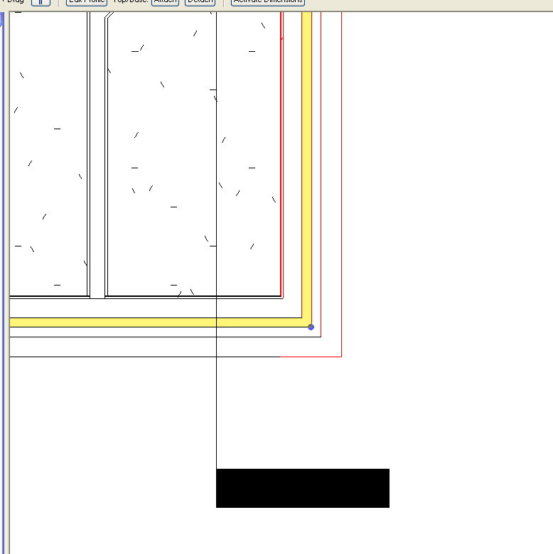

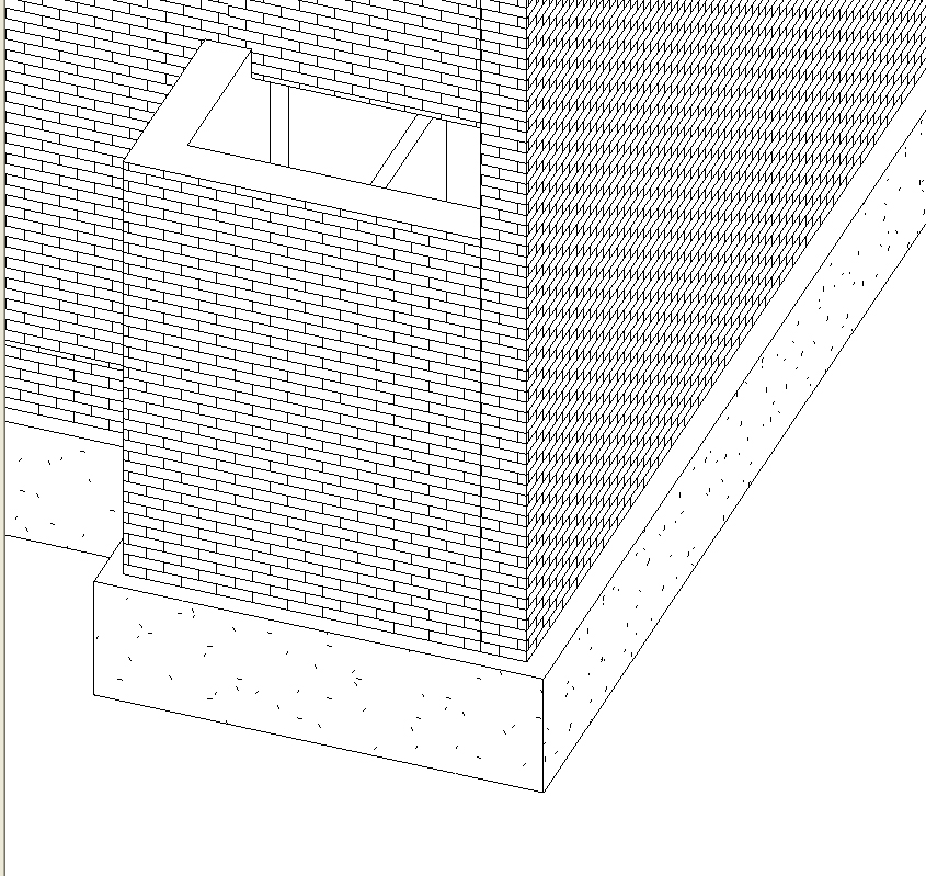

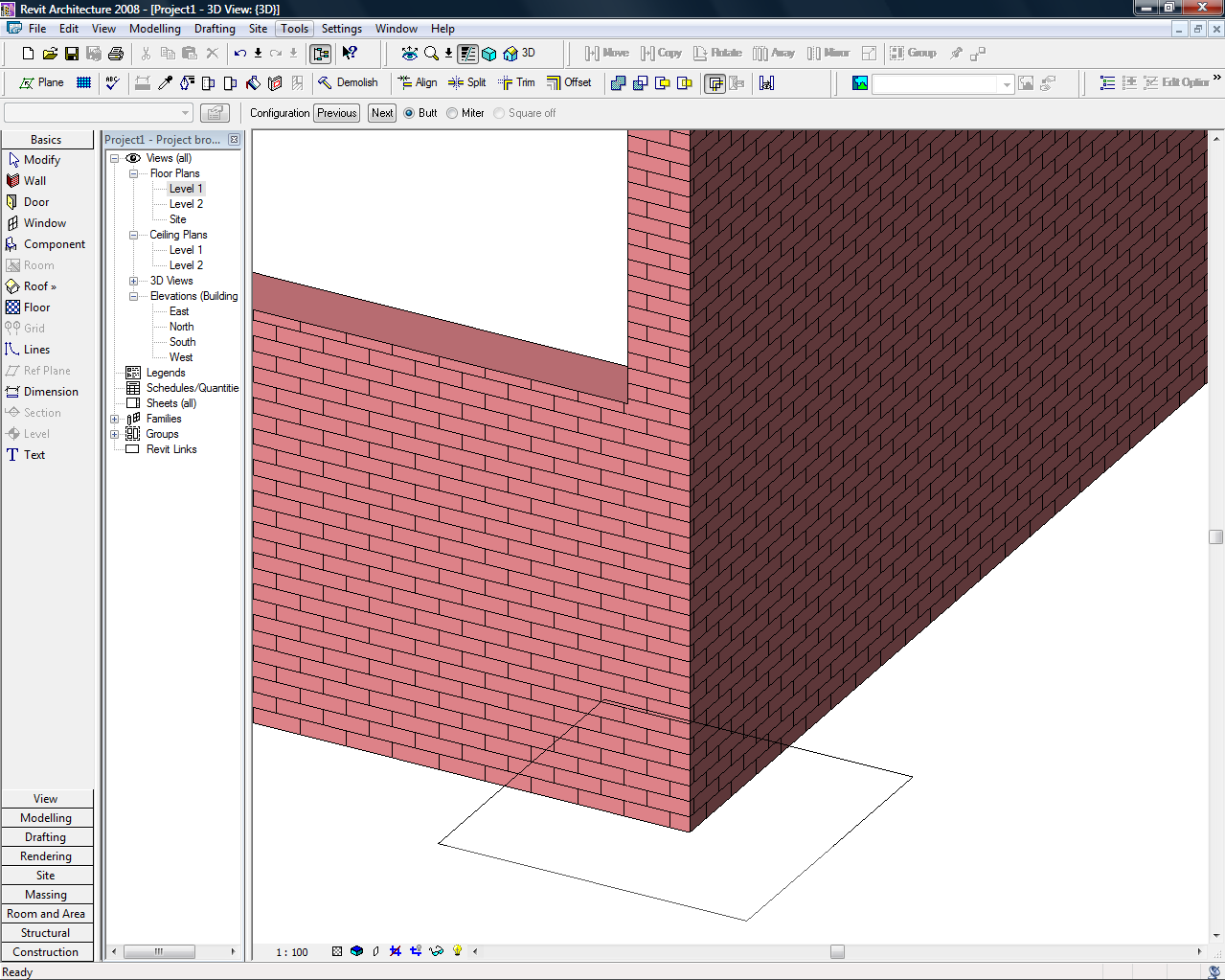

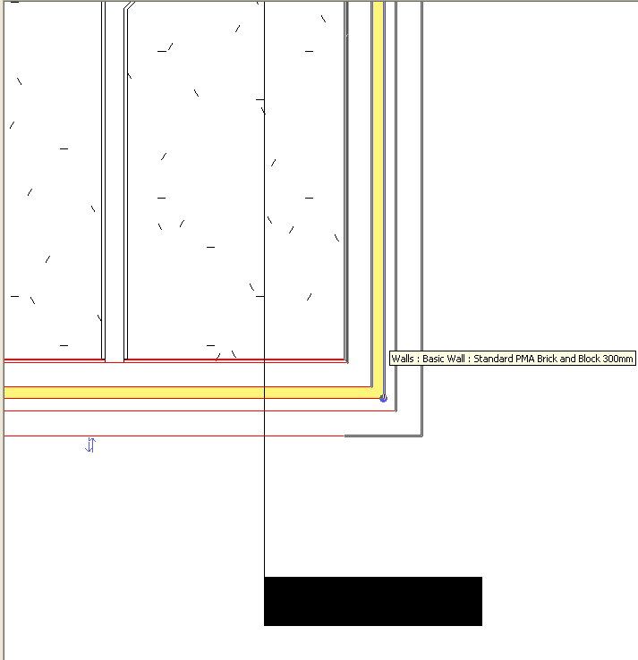

Hi all,
When im joining walls that were not draw in one go, the wall ends keep showing up in 3d and elevation views. In plan it doesn't matter, the join is seen as a mitred join, but when one of the walls in the join is selected (turning it red) you can see the wall end not mitring - which is showing in 3d and elevation. Hopefully the pictures attached will make it clearer.

Hi, make a trim between the 2 walls and "Join Geometry" and "Edit Wall Joins"...

Do I need to pull the walls apart before that, ie break the join? Ive tried both ways, if I dont pull the walls appart it wont let me trim them together but when I do pull them apart, trim, and then try and join geometry it gives an error that "Highlighted elements are joined but do not intersect." Ive then tried to unjoin them but nothing happens!

Hi, i go put here a video, wait a moment..

Here is the video: http://screencast.com/t/VF1nPX7rnib
Give me a feedback, ok?

I seem to have got around the problem with that, thank you. I can see a mitred join on top of the wall which is slightly annoying but it won't show when the roof is on. Thanks.
