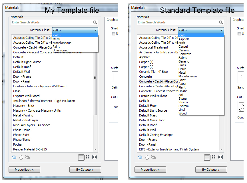

I've been working on my firms standards file, and started from a blank file to make sure I was in full control over everything. This has been working out just fine, untill now.
I'm trying to create walls, and noticed that the material library is my template file is far smaller then in a regular default template file (see image). Can somebody tell me how I can load all of these into my own template file as well??
Thanks!!

Hi, open your ORIGINAL template file (*.rte), then open your STANDARD template file (*.rte), go to File-Transfer Project Standards, check all and OK, save the STANDARD.rte, i think this solve the problem...

Thanks Typhoon! That totally did.
