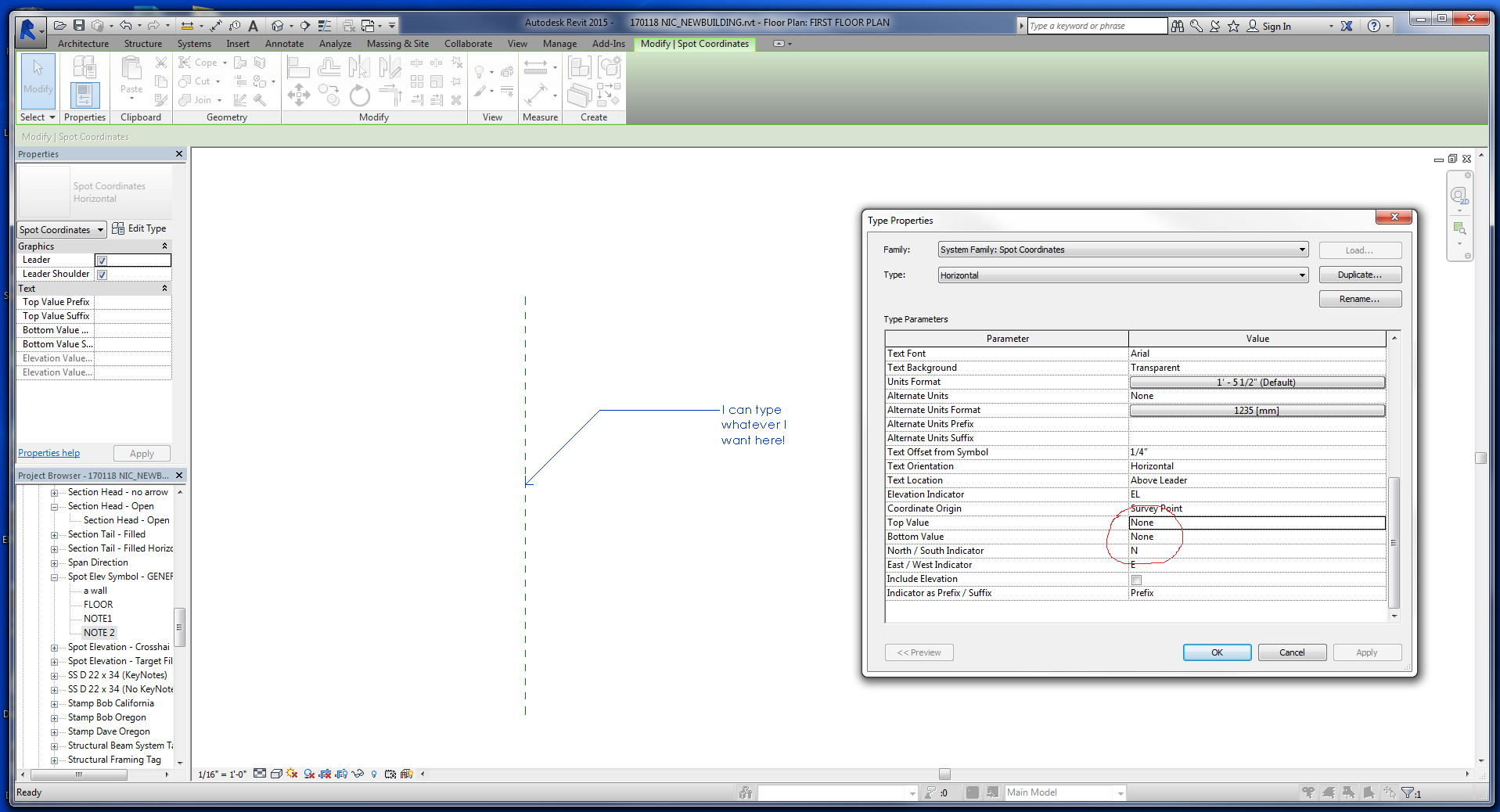

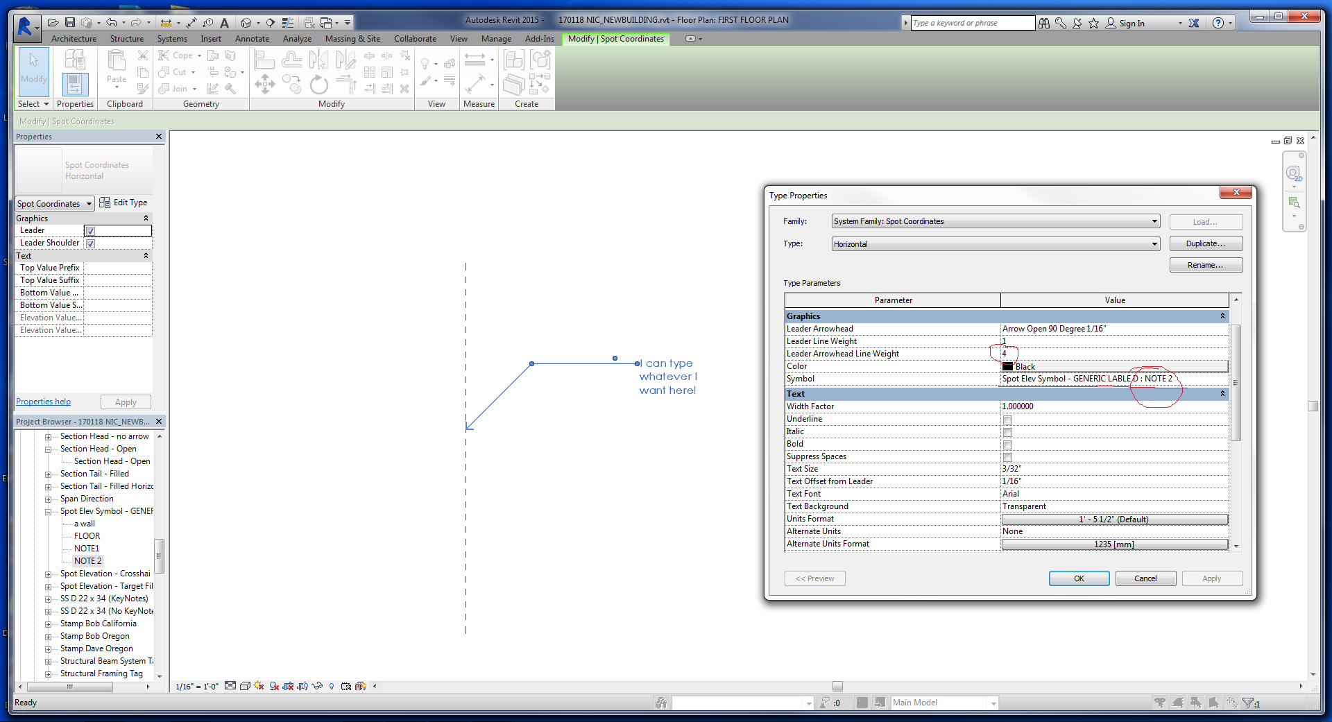

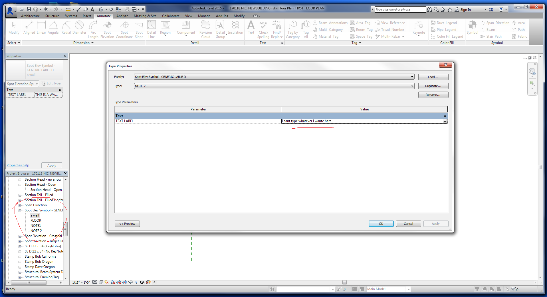

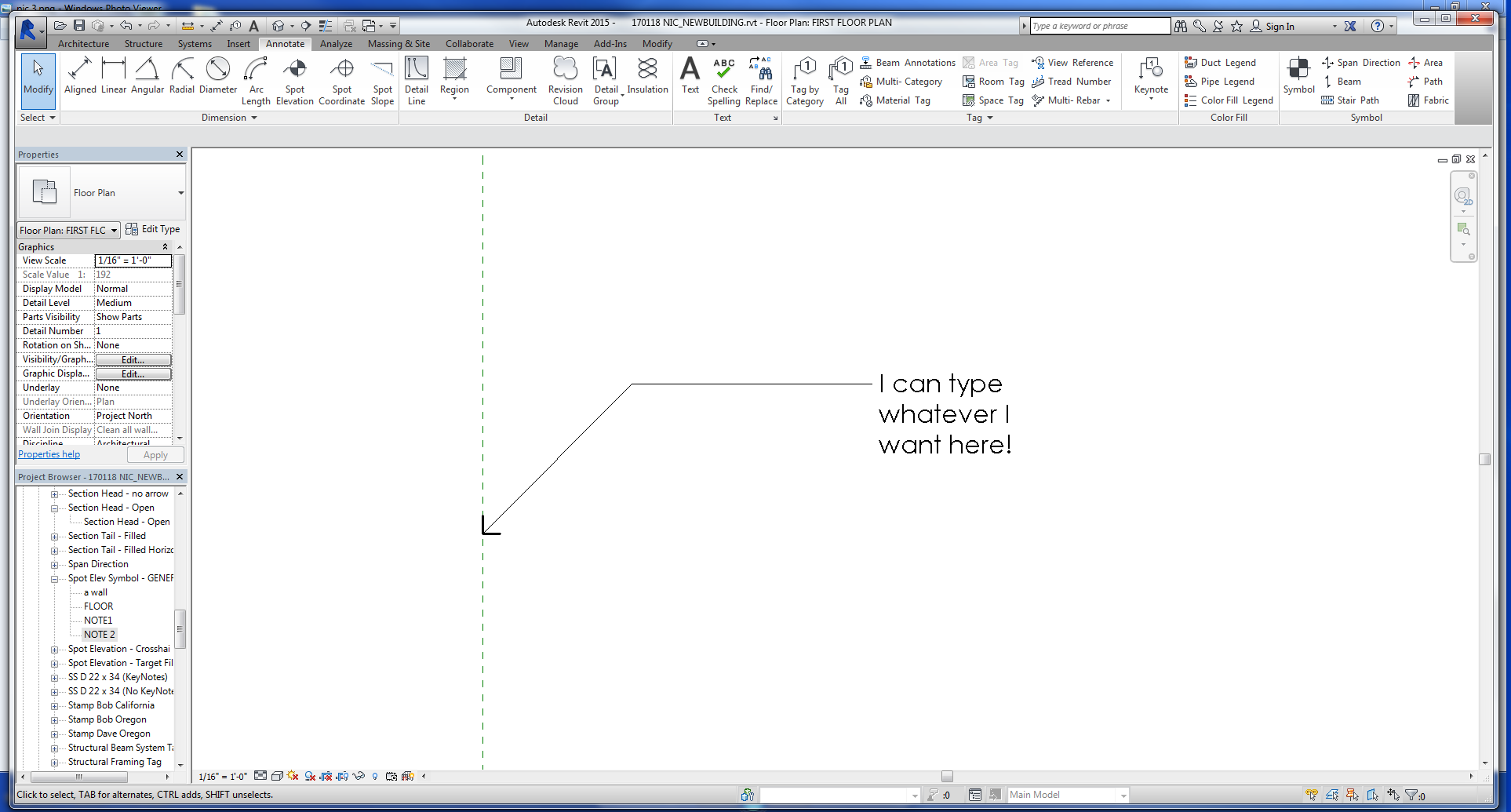

Use a spot coordinate instead of a text leader... photo 1: You gotta go into your property browser and scroll down to "spot elev symbol" open any one of those sub categories and duplicate. Type the text you want the leader to say here.... now, photo 2: make a spot coordinate, (you'll need a reference plane because it is supposed to attach to walls and whatnot.) Edit type - change leader to arrow head of your preference. change symbol to the text you just created in the project browser, and edit the line weights accordingly. Photo 3: scroll down in the type properties and change "top value" and "bottom Value" to none. AND MAGIC! pic 4: FINISHED! Unfortunately there is way too much text in my project to make a new text for every single one..
