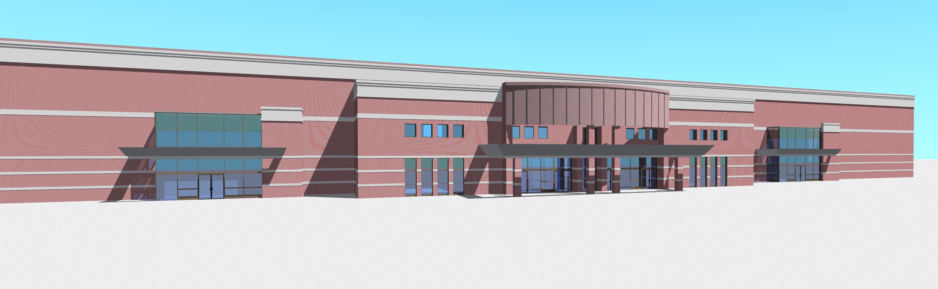

I'm trying to render a large brick building but the brick keeps coming out with swirls in it. Is there some way of getting rid of that? It's not a terrible thing if I can't, but my perfectionist eye looks right at them everytime.

You might check the scale of your brick.  It looks a little small.  The "swirl" usually appears when the rendered pattern is either too small or the render resolution is not high enough.  If the brick size is correct, try a higher resolution.  Hope this helps.

2 words - Moiré pattern
